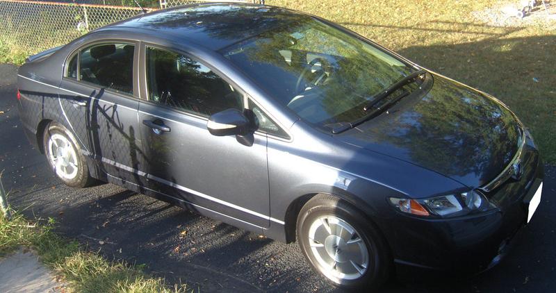

I just spent Saturday installing the following factory (OEM) items.
Fog Lamps - $250.00 from Honda
Interior Illumination - $70.00 from Honda
Auto-Dim Day/Night Compass Mirror - $250.00 from Honda
I will warn you, this is not an easy task and requires most of your day to install.
I painted the fog lamp covers the same color as my car (Majestic). I wanted a more natural look to the lamps installed and OEM black wasn't cutting it for me.
Removed front bumper and cut into the designated marks that Honda made on the inside of the bumper.
Honda has done a lot of the pre-wiring for the lamps from the factory, so you just need to install the lamp cable to the pre-run one on the passenger front near windshield fluid container.
Inside the car you need to replace the headlight switch assembly with the one in the fog lamp box. This adds fog lamp functions to the steering column instead of the dash as found with the cheaper kits found on eBay. You will also run another cable of the fusebox to another pre-wired junction cable under the dash. Ground the cable and re-assemble the dash.
Since I purchased all three major kits from Honda, all the kits required removing the dash so with the dash removed, I installed the Interior lighting kit which also required drilling holes into part of your dash. Please note, all pieces that are drilled can be replaced at a nominal charge.
Interior lighting requires running the main power cable for the kit from one side of the dash to the other, starting from the driver side and working your way through to the passenger side. I had my Civic on a lift and it was still pretty painful to work in such a small confined place. Anyone looking to do this should invest in a head strap light so you can point the light where you need it. After running the cable through, you can connect the end cable to the fuse box.
Auto-Dimming Mirror. Remove old mirror and save the clips. (eBay mirror to recoup some cost) Remove visor and visor clip, map light, handle on driver side, and A-pillar trim (where it says "Air Bag") You will need to use a rubber mallet to hit under where it says Air Bag (no joking). Run cable from A-Piller down to fuse area. Then fish cable through roof coming out where the map light is. Attach mirror and cable.
I didn't take pictures of the procedure, I thought about it midway though and said, F it. The details above are definitely condensed and requires most of your day if you decide to take this on. Since I saw how much was involved with installing the fog lamps, I decided to purchase everything else I wanted anyway. I am glad I did do that because this car is very small when it comes to working the space they provide you.
I also purchased aftermarket chrome door sills that I plan on installing next week. I will also have the tint shop put in 50% tint on all the windows and add a tint strip to the windshield.

Re: Just installed some factory options
Pictures!!

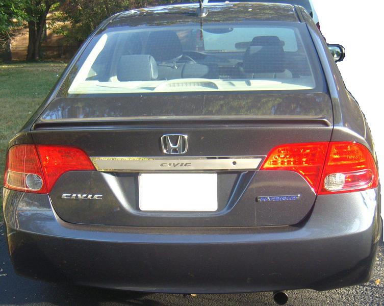

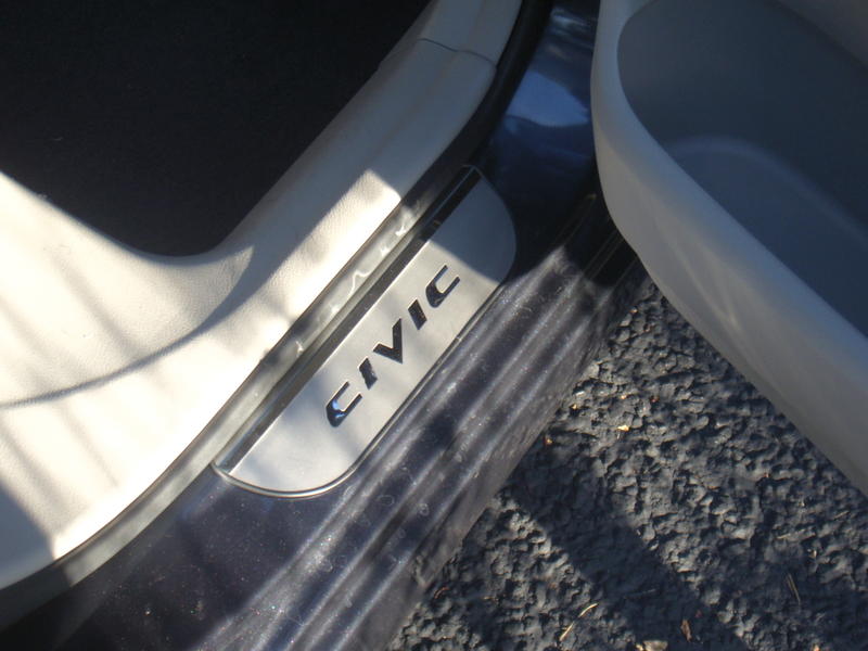

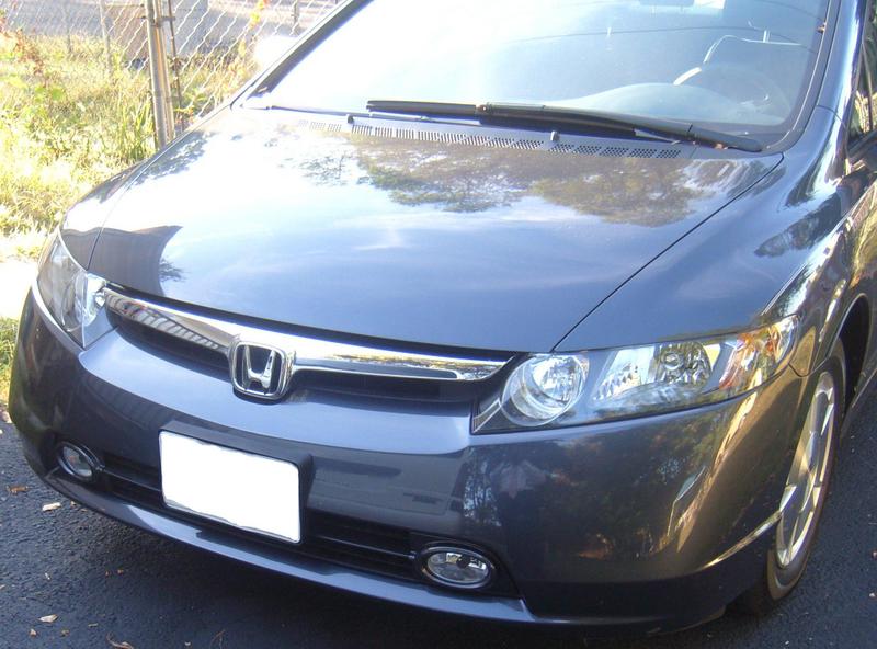

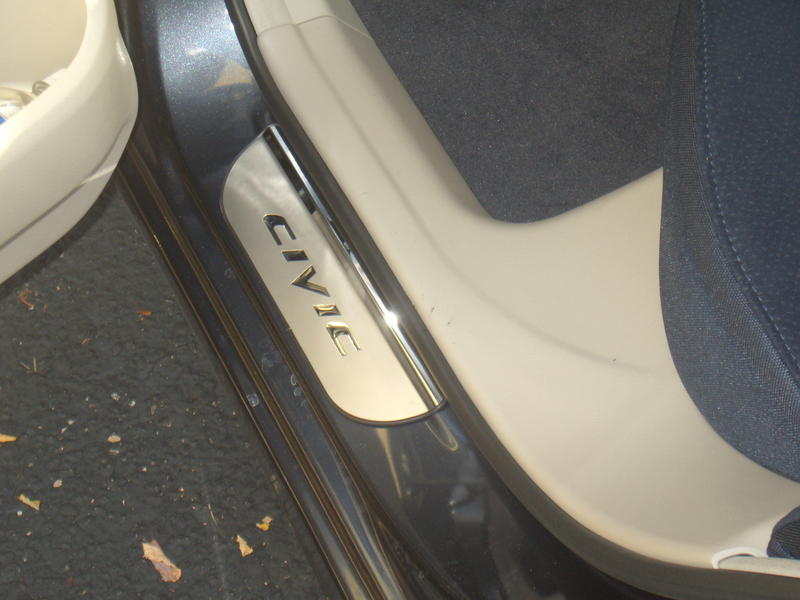

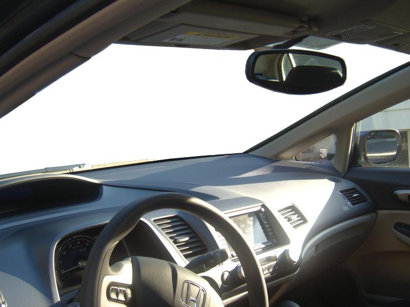

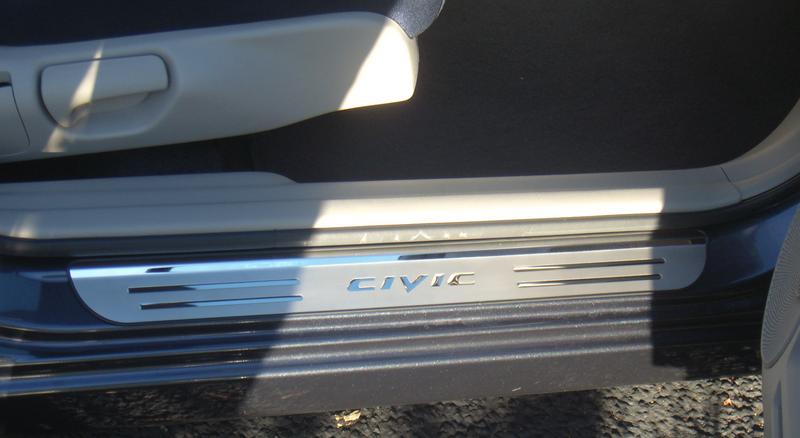

ID:	72807   Click image for larger version
ID:	72808   Click image for larger version
ID:	72809   Click image for larger version
ID:	72810   Click image for larger version
ID:	72812   Click image for larger version

yea, looks really nice, love the door sills, where did u get em
Old Oct 17, 2007
arbittan's Avatar
Joined: Oct 2007
Posts: 25
arbittan will become famous soon enough
I got the door sills off of eBay under seller name: partplaza
I got the back end finish off of eBay under seller name: goody4less
The other parts were from the Honda dealer.
