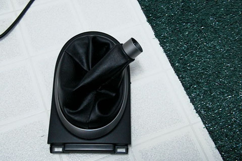

Would anyone happen to know if an 03 Civic would be done differently. Would I still have to take out the middle console? I'm looking at the manual shift boot I bought and it looks like it just snaps into place. So I'm wondering if the automatic shift boot is also held by clips and can easily come off.
Sorry, I know pics would help. I'll post them later on.

Okay, here's the manual shift boot I bought. Notice the clips? I'm wondering if the automatic shift boot is held the same way so that maybe I won't have to take out the center console.

You will probably still have to take the console out because the automatic is held in by some screws.

THOSE OF YOU WITH A 2003 CIVIC:
you do not have to remove the center console at all. the piece is indeed just clipped into place. you can simply rip it out *mumble* luckybastards..
ALL 2001~2002 models are being held on with screws, and you must remove the center console.
