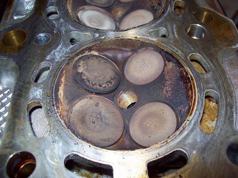

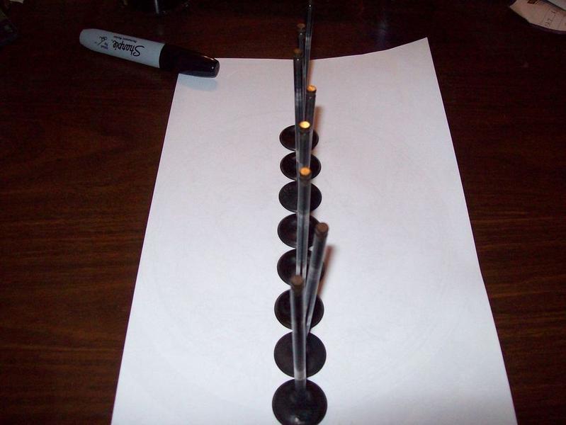

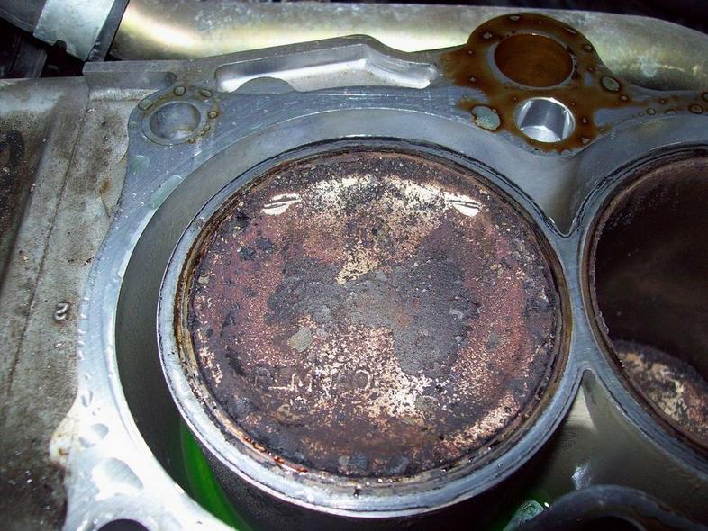

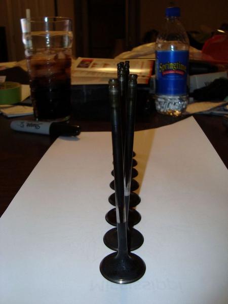

I pulled the head last night and, so far, all of the intake valves are bent, but the exhaust valves look like they did not touch the piston. I am going to pull them tonight and check. There is a lot of carbon built up in the cylinder 1 intake ports. The spark plugs are the originals with 8 years and 110k, so I am thinking that poor ignition is the cause.
What is the best thing to remove the carbon and is there anything I should use to clean the head other than degreaser?
I will post some more pictures tonight.
