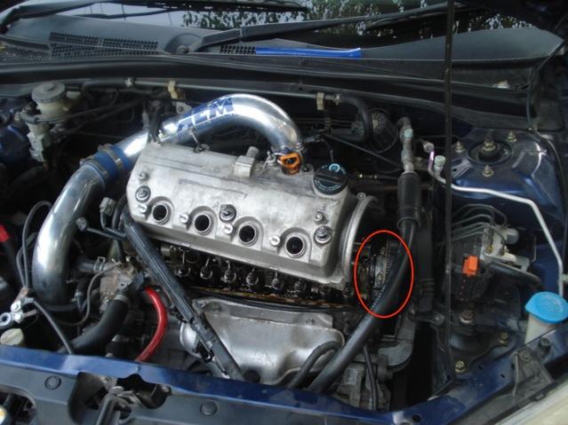

I replaced TDC sensor and now oil is sweating from between the seal.

Sounds like either your cam seal, or your crank seal is leaking. Take the cover back off and look around behind the cam sprocket (that's the one at the top), see if oil is dripping from the seal there. To see the crank (lower) seal you'd have to remove the lower cover, which means removing P/S pump, alternator,motor mount bracket, crank pulley, plus everything aforementioned.

Oil is seeping through the rubber under the topics cover.
I mean, it must be coming from somewhere under the cover, 'cause oil isn't going to be coming out of those wires that go through the grommet.
You have to look behind the pulley at the top in your picture there, that's where the cam seal is, I just replaced mine, it was leaking and oil was going all over under the covers because the belt turbulence was scattering it. Another thing I thought of on the way to work this morning is, when you put the valve cover back on, did you clean the gasket surface on the head thoroughly and put RTV sealant on the sharp corners of the gasket? Did you torque the valve cover bolts to the right torque?, and in the right sequence? The oil could be leaking out of the valve cover and into your timing cover.
no I did not do the cleaning;
I did not use any sealant;
I did not use a torque wrench, I used a regular 1.
I retighten and one of the bolt - (front left) popped.
The timing belt soon need to change that's what I have'nt taken the car to the mechanic, I plan to do every thing once - mileage is 91k km.
but in the meantime, I want to solve this.
Problem solved. Take the valve cover back off, clean the gasket mating surface thoroughly,be careful not to gouge or scratch the aluminum, get a new gasket, apply sealant to the corners of the gasket where it meets the cam bearing caps, put it back on, tighten each bolt a 1/4 turn at a time in the right sequence, until you get the correct torque( 86 in-lbs or 10 Nm).
