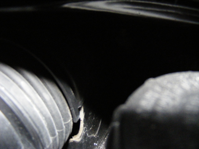

I had made another thread about this but I now realize it could potentially relate to my stalling issue. I noticed my intake is cracked and has a nice hole in it.
would it make any sense at all that this could be causing the stalling? maybe cus the engine is getting bad air? rather than the nice filtered kind.

thats not causing it to stall but that could be why your TB and aic valve need cleaned. If thats where I think it it then you are getting dirty air straight to your engine before its passing thru the filter. Do the above mentioned maintenance of cleaning the TB and such and patch that hole or get a new air box.

an air leak could explain the stall too. normally there is vacuum and when you have a crack or the intake removed, the car takes alot longer to start. and you are changing the amount of air going to the engine so the ecu gets confused. the intake needs to be completely sealed up.
