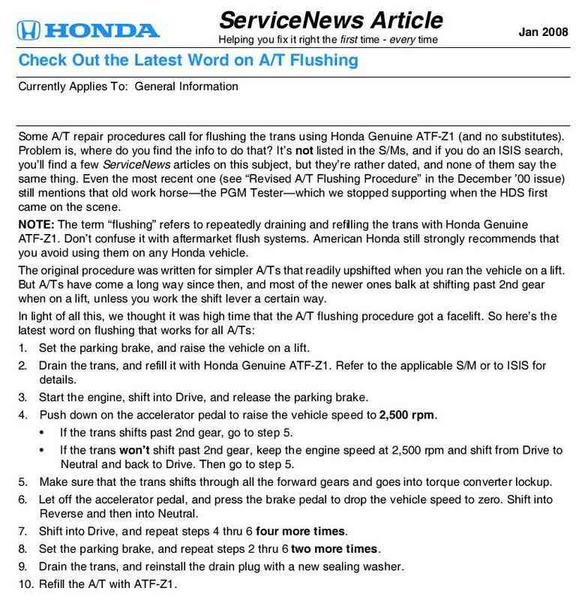

You've convinced me not to flush as shown in the YouTube but at this point I plan to change the oil according to the instruction I found on the Internet today. Click on the attachment below to enlarge. I couldn't believe Honda actually want us to dump and fill 4X. What a waste but I'm going to do it.
Again, thanks for your feedback gearbox,
Honda-99
Originally Posted by gearbox
dark red is still fine. its when the fluid turns orange that its time to worry. i would just do a single drain and fill if youre set on changing it. drive around and do a second drain and fill 6-12 months later. this gives the new fluid a chance to mix in and not do too much damage.

okay but 4x is a bit much, and the fluid costs around $7 a bottle. thats almost $85 for drain and refill four times. ive only done one drain and fill at a time and the fluid always looks good if you do it yearly. i would say 2x should be enough for you to remove most of the old fluid the first time.
