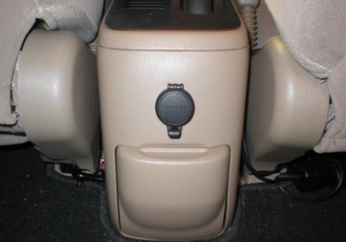

Also frustrated by power outlet location.
I did this a while back since I hated it when couldn't use my power outlet with a drink in my cup holder. Also, there are times when I like to use more than one accessory, and needed another plug but wanted something cleaner than a multi outlet adapter. The only place I could find that would somewhat appear to look like a factory install with enough room for the hardware was in back of the center console above the rear cupholder.

wish the picture still worked
