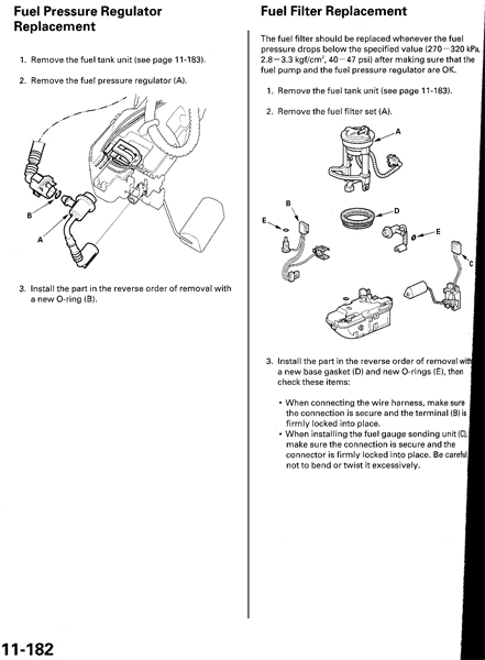

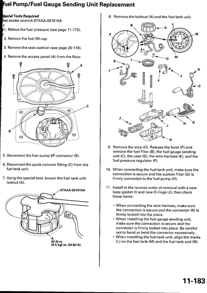

I was just looking at the install/remove diagrams from the Helms manual and thought this might be a cheap mod.

Here's some pics

yeah i know that all too well. i've been in and out that tank more than i can count on my hands.. the only thing you can do there is upgrade the fuel pump.. theres really no room for anything else, especially adding more stuff.
