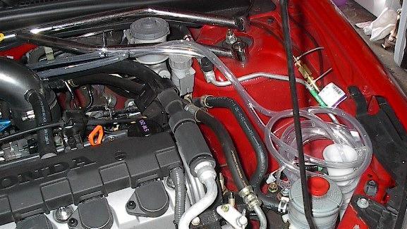

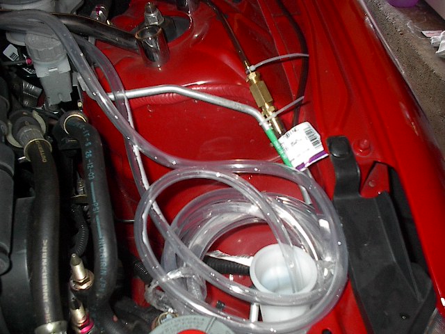

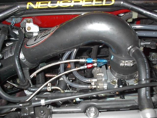

Liquid cooled throttle body, test phase one completed.
Old Jul 23, 2005
Redline04's Avatar
AKA Mr. 60ft. Not to be confused with Civic_Redline
Posts: 752
From: Barksdale AF Base LA
Redline04 is an unknown quantity at this point
Well after getting the idea on this thread here http://www.7thgencivic.com/forums/sh...208122&page=23 I decided I had to see if it would work. Well it does, but.....
The water didn't stay cold long, if I filled the whole container with ice it may have helped but I gave up after a few and just poured some chilled water in there. The damn kneck is so skinny it's hard to fit ice cubes down there. Crushed ice would be best. When I tested the system in my garage it made the throttle body ice cold. Went out on the road seemed to pull pretty good. Drove around for a bit. Got on again and couldn't feel any loss. Turned the system on as people were probally laughing at me cause my wipers were going on a clear 90 degree day(haven't figured out that problem yet) . Made a u turn and got on it, couldn't tell a difference. By this time the water probally wasn't ice cold cause it sure wasn't when I got home. So at this point test phase one was a funtional succes but not results wise as far as can tell. Maybe If i packed the resivour full of ice this would make a difference at the track. On the street with the exception of a predetermined race it would probally be useless. Still need to find some of that fuel line to wrap around the intake for phase two. Another idea popped into my head as well. Instead of liquid cooling everything why not air cool it with CO2? Not sure how CO2 works but if I could find a way to recirculate it through the throttle body and around the intake maybe that would be better? Or just drop some dry ice in the resivour? Dunno but it was fun trying something new. I'll keep at it. Need to order my odysee battery so I can do my headlight intake still, cause the filter location of tha V2 is killing my HP in this heat.

Originally Posted by gearbox
as a quick fix, I'm sure there's a wiper fuse you could pull at the track so the wipers don't work.///
yeah I pulled the wiper fuse in the cabin but that cut the pump or what ever pushes the water as well. This was just a prototype. I guess I could find some black hose line somewhere and use that to make it look a little better. So you can put dry ice in water? I wasn't sure if you could. Cool. Maybe I'll make a trip to wally world later. Like you said I need to find away to crush it though. really need to do some testing at the track after I wrap the intake and see if there is a difference.
And yes I was bored. Suppose to be working on a speech for tues but I am procrastinating.

BTW this took all of about 5 min to hook up. So it could be put back to stock for use of wiper washer on the street then easily swapped back for the track. Now I just need to get some dry ice and see if it is worth it, oh and figure out the wiper issue. My friend just ragged the **** out of me when I told him what I did and how I was driving down the highway with the wipers going.
Old Jul 23, 2005
Redline04's Avatar
Posts: 752
Ok I just took everything off cause I have some races hopefully going down tonight and I don't want people seeing that rigged setup in the event I do pop my hood. I notced the throttle body was actually quite hotter than when I intially left it sitting in the garage for the last hour or two. So I guess maybe it did work. Still could be colder with dry ice though.
Aight Im out for the eve hopfully I'll have some win stories to tell. Supposed to race an R32 and a cammed specV with other mods. Running the 50shot for the first time since Im up against some stiff competition. Hope the clutch can handle it. Later Everyone.
The experimiment shall be continued at a later date.

if you want to run dry ice, use antifreeze mix instead of water.
Chemically, pure water cannot go below 32 degrees F. So that means that you will never get the TB any colder than that.
But then again, a very cold TB brings up another issue itself.... freezing.
