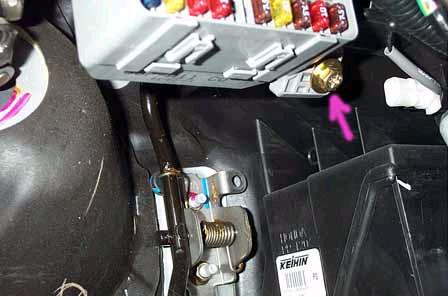

and i tried looking at the relat under the steering.......and boy....that thing is very very hard to replace...i've to take out all the cables before getting some acces to the relay...

unscrew it, there's a phillips screw at the bottom then that whole fuse box slides down and u can get to them so much easier, u can use a phillips screwdriver or a 10mm socket to get that bolt

zen_master's Avatar
Posts: 3,784
holy **** what...LOL
yo, thanx alot, buddy!!!
so the whole thing will just slide down? wow, that's c000l!

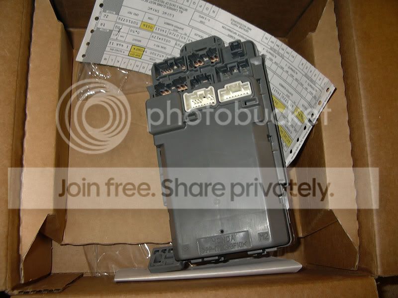

Hi guys..
i just got the package today....................
IN NOMINE PATRIS ET FILII ET SPIRITUS SANCTI
hopefully this will cure my car...........................................
