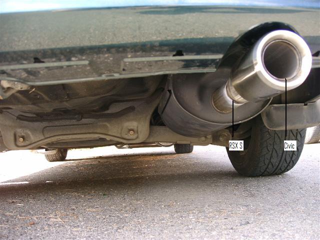

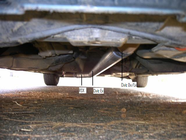

Here are two pics showing the differences between the civic and the RSX Type S Tip. The tip diameter of the civic is 1.75" while the RSX S tip is 2.5", just the tip, not the whole exhaust piping. Also you can see where the stock b-pipe front flange goes for EX, DX/LX and Type S. othe than those two modifications, the exhaust fits perfectly. It sounds almost like stock, mostly because both the resonator and the muffler are bigger on the RSX as well as the piping.

in the second pic did you have to extend the tip or something?

Yes, the tip has to be extended, so it match the civic bumper. The RSX is a bit shorter than the civic, that's why you see a weld in the marked aea, where the RSX was and where the Civic is now. The Chrome Tip can be unbolted and relocated in the new pipe extension.
