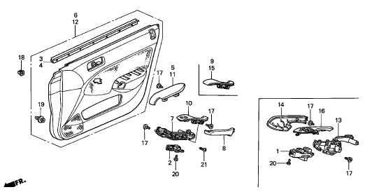

When ever it rains or a wash my car the front pass side speaker located in the door get wet and sound horrible. I was wondering if anyone else has had this problem and what to do to fix it. The only thing i can come up with is replacing the weatherstrip around the glass in the door. Item #3 and 4 in the attached pic. Does anyone have any other ideas on what I should do to stop it.

that or a buy a speaker baffle
http://www.crutchfield.com/S-phax6mm...&search=baffle

Thanks i had not thought of that. so, that is what those things are for

I am guessin you just poke a hole in the back to allow wires out and tape them up.

I don't think they are for waterproofing the speakers
Just for better sound, but in your case it could possibley help

No that won't work. There is a bar behind the speaker so those won't fit behind there unless you cut it up, and then it won't help much anyway.
But my speakers get wet all the time. When I opened em up again to redo the install, there was water all over them. Still works fine tho. Do you have aftermarket speakers...because those should be water resistant. Factory speakers are paper and will just rip.

Originally Posted by PunkingCivic
I put a set of these in ages go. Everytime I wash the car, the speakers got soaked. The baffles work well, but you have to fit them a bit. I also used a little silicone where the wires poke through.

Yes. Took some fiddling to custom fit them, and some cutting. I ordered the shallow ones, and so far, no problems.

By installing speaker baffles, depends on the correct way to install it (I really don't know what is the correct way anyway. If somebody knows it, post it here please.), the bass response may not be that great. I tried installing between two spacers(because my old Type-X was deep), it was actually leaking because there's no way to seal on top of the baffle. Very annoying. But if I install it right at the buttom of the speaker, and running 2 tiny holes for the wires(actually the rubber on the wires seal up the holes too), the pressure is very high. What I mean by very high is that, I press on the cone, have to use some force to do it, and it comes back out very slow. However, upper midbass sounds nice though(because it's tight). Lower midbass suffers I guess.
