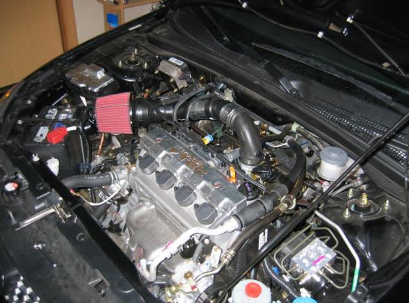

bahahahahha i laugh at myself for even putting this in my car. i spent a total of $7 including the filter.
ok now, please no "maan just buy an intake." i just like making my own things instead of buying it already made. yes it works, yes i have no more torque, yes the high end is a bit stronger, yes its louder, no it wont melt, yes im insane, yes its ghetto. thats the point

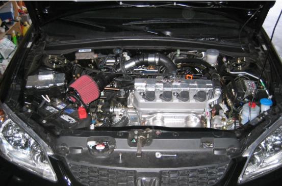

pic2

home depot is your friend. the materials list from the throttle body to the filter is:
2in rubber elbow with pvc pipe clams
tiny section of 2in ABS plastic tube
20degree ABS plastic bend
small length 2in ABS plastic tube
45degree ABS plastic bend
small section 2in ABS plastic tube
2in to 3in rubber PVC plastic clamp adapter
cheap-*** filter

wow - holy heat soak batman!

It doesn't look to bad compared to the vacuum hoses people had been using.

Q: Why is a $300 intake any better? When it all comes down to it, it's just a filter on a peice of pipe.
A: That's a good question... .... .........
And here we have the proof of concept.
+10 for creativity and all that schtuff....
Good job, make it DIY: po'boy intake

well this is probably with all SRI but the sound right above 4000RPM at WOT is like a sound between a growl and raspy. sounds like an actual VTEC system its wierd.
thanks for the compliments!!!
it pulls so much harder, i notice this cause it offsets the incredible loss of torque down low

would the pbc transfer heat as fast as a metal one? I would think that this would even deliver cooler air...well if it were cai

I'm willing to bet this would out perform AEM SRI's if you had a nice filter on there (a K&N one would be perfect). The whole thing is plastic which resists heat, much better than metal.

yeah i noticed that my ractive filter is crap (haha got it for like $13, paid $3 difference after gift certificate). but K&N's are expensive. how cheap haveyou guys got them for?
revving the car in neutral sounds about stock cept a bit louder. but once im in gear and at WOT its raspy/growly as hell. loud too!!!
