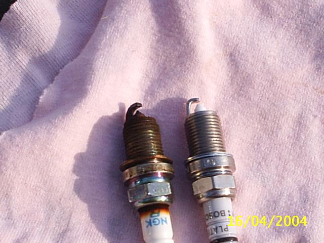

so i hit 40000km yesterday (24854 miles), and the weather was amazing today, so i decided to change my spark plugs to Bosch Platinium. easy job, but the Stock Sparks are sooo rusted. Is this normal for only 40 000 ? i mean the dealership only says to change them every 80 000km. so is it my driving or is it that the OEM plugs are crap ?

Another pic

i put ngk iridiums in my car, and they looked exactly the same as the o.e. plugs
Old Apr 16, 2004
Rep Power: 812
I also replaced the stock plugs with NGK Iridium IX at 18k miles. Player, those look bad...both of them. Bosch sucks.

i changed my plugs 2 weeks ago for the first time since i'v had it and my car has 50k on it,they looked just like that too i also got the bosch plugs as well and it made a nice differance.next time i will get the iridiums when i can spend 50 bucks on plugs

Re: Spark Plugs, WTF
Dude, look a the tips. Those look burnt - as in either your car was running too lean, or your running too hot of a plug.....maybe try one grade cooler plug.

Re: Re: Spark Plugs, WTF
can you explain this a bit more, my car is all stock engine wise, so whatd do u mean too lean or too hot.

Old Apr 17, 2004
opto_isolator's Avatar
Posts: 3,024
Rep Power: 312
Re: Re: Re: Spark Plugs, WTF
as for milege, i wouldnt know, i juts did this today, but my Idle RPM are a bit lower know and the car is quiter at idle
The ceramic on the base is brown, its burned. Look at the electrode (the part that goes into the engine). Take some clear pictures of those. Most likely if it was just that plug you may have had a bad plug. If the electrode is worn down pretty good, and the white ceramic surrounding the electrode is fscked up pretty good than you may either running lean in that cylinder, or the plug is crap.

Theres nothing wrong with those plugs you took out. They're used!
I've got 85k miles on my stock plugs, car runs the same since day 1!.

Those spark plugs look fine. They looked burned, because they are. Why? Its in the combustion chamber. Duh. What happens in a combustion chamber? Fire. If the car is lean, it will be a lighter shade of brown. Rich, darker black. speckled usually means detonation. Also a statement like: "dont buy bosch, theyre a european company, and putting that in an import car is bad" is completely and utterly retarded. If its a european company, wouldnt that have to be imported too?! just like a BMW is an import. Its a european import not a japanese import. Since when have only asian cars been considered imports? And generally "Rust" as its called, is oxidized Iron (III). Also known as iron oxide. Aluminum oxide is not generally called rust in any sense of the term. Granted it is a similar chemical reaction. http://news-service.stanford.edu/new...minum-517.html has some good info about it.

my ngk stock plugs looked exactly the same when I changed them at 30k miles. wierd.. but now I am running bosch plugs..
