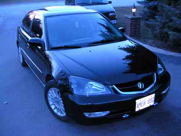

just did mine
i agree. getting them apart is the hardest part. why pay $50 after you do most of the work. They should be fine as long as you seal them properly. I wouldn't think there would be any way for the paint to peel or crack after you reseal them. just make sure you use the right paint. I sanded the shinny crome off first and then used a new paint from home depot meant for plastic. It looks good, especially since there are no aftermarket light for my car, i am very happy with the results.

one more
because i like it!

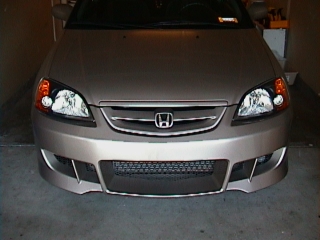

ok i finally downsized my pic

Thanks to everyone. I got it done! Pain in the A _ _! By far the hardest DIY I have ever done. Started at 6PM and finished at 430AM the next day. Had to get it finished before my front end was put on that morning.

Old Apr 15, 2004
zen_master's Avatar
Posts: 3,784
nice!
nice bumpers too!
can you tell me about it? what brand? how much? where to buy it?

Tsunami. Paid $200 shipped a while ago on eBay. I believe there is at least one vendor on the site who sells them. Try a search?

^^^ Wow, looks like you did a great job. Did you keep the orange turn signal piece on and put masking tape over it while you painted it? or did you take it off before u painted it?

I took everything apart, taped off and sanded. Painting was the easy part.
Went to a local auto paint supply store and bought 1/8" and 1" rolls of quality tape (no residue), some good plastic paint and 3M sealant, all for about $25.
