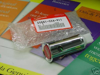

gotcha. from the picture below, looks like a little hard-wiring must be done to the back of the button assembly. any diy for that part?
