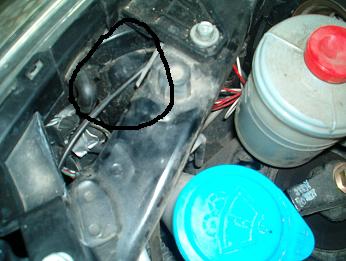

here are some pics... the thing circled is where the light bulb is located.. i removed the power steering thing, but its more the windshield fluid that is in the way, and also that silver "bar" thing is in the way...

then you have to take your front bumper off, and take the projector off :x Grr! (:
Old Nov 17, 2003
speedracersong's Avatar
Posts: 6,448
Rep Power: 362
yeah follow impulse's advice.
i had to take off the whole bumper just to replace one bulb.
unless you have a really small hand...

If you have Matrix halo projectors than you can get the drivers side out w/o removing the bumper. I did it last month. Remove the power steering reservoir, and reach in from behind and under the bracket. I don't know what kind you have, are they the RS ones?

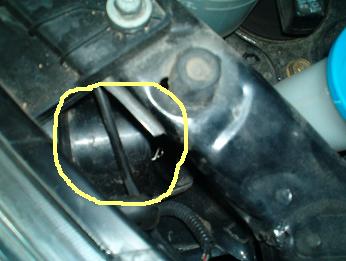

i can somewhat pull off the black rubber thing, but i cannot get the bulb out, and if i would get it out, i wouldnt be able to get the bulb back in. that silver 'rod' is in the way, as well as the windshield liquid. the rod looks like it can snap off, but i dont want to mess up anything..

I have the same projectors and also have to change my bulbs constantly. You DO NOT NEED TO REMOVE THE BUMPER!!!. Just pull out the bottle with the red cap (washing or steering wheel fluid, not sure) and thats it!. It takes some effort, you just gotta wiggle it left and right while pulling up. The bottle is just connected to like a metal plate, not even screws or anything. Just wiggle it out, and youll be fine!!!. I have a 01 LX sedan, and thats how I do it, takes 2min to change my bulbs.

if its because of that "silver-rod" your supposed to push-in than push up. Im guessing its the metal rod in the housing, you should be able to move. You really have to look at it closey. If its another metal rod within ur engine bay, then maybe u have to take of ur bumper, lol. But, I dunno, you should be able to take it out without removing the bumper.

its the metal rod from the engine... u can kinda see it in the pics... it goes from the side of the engine, to in back of the light, then down

in my tyc's i had to use long needle nose pliers and surgical precision...lol, it sure beat removing the whole light tho...and for the person who asked about the tyc's...bulb life is pretty good, ive been riding with MTEC 4X for about 2 months now. but before that i had the ones that came with the projectors..i had those for a year and when i replaced them, neither was blown, i just wanted different bulbs.
