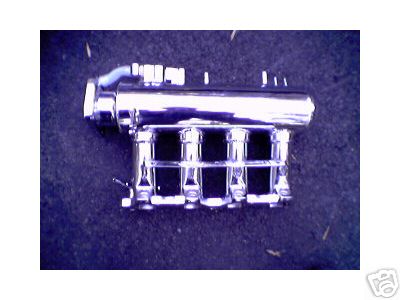

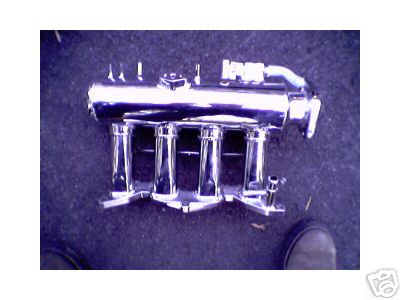

i wanted some people views on which one they think would be better an intake manifold with shorter runners or with longer ? im looking to get one for my 95 civic and dont know which one to get one is a custom intake manfold that looks like the obx intake manifold a picture is attached below and the other is a stock manifold which has a longer runners but is ported and polished by gude i dont have pictures of the gude yet but will put up later

attached is a picture of the stock port and polished manifold which one do people think would be better for performance ?

i would go with the port&polish

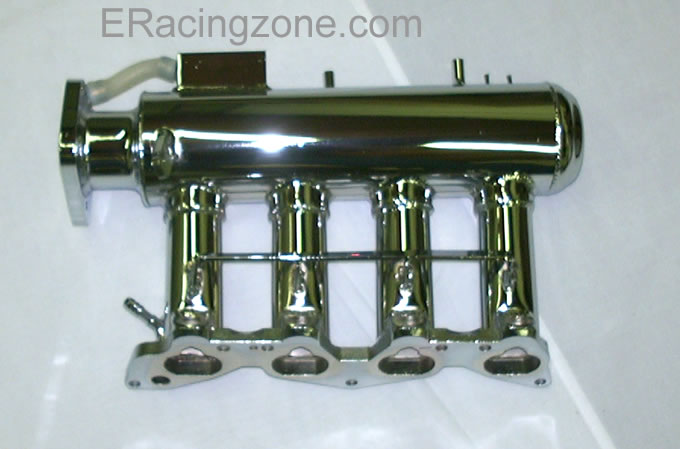

and here is a pic of the obx intake manifold

is it just me or does the first manifold look the same as the obx manifold ? the guy never said it was an obx, heres another view

Old Oct 17, 2003
djmota's Avatar
Posts: 3,242
From: so cal djmota=oscar
Rep Power: 324
what are the mods on the 95 ...cam, head work ect??
if none then i would say go with the ported original.
If a cam, cam gear, throttle body headwork ect are in the near future than i would say go with the aftermarke intake. But i would not trust obx to make a good manifold, i am thinking more along the lines of skunk2 or something. oh yeah they do look different.... not much of a difference in runner length.
