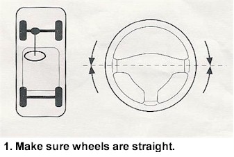

Name:	01 momo install (straighten wheels).jpg

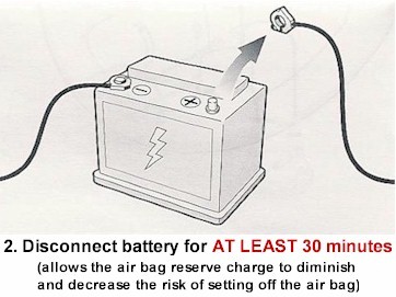

Old Aug 21, 2003
poor jaysun's Avatar
Posts: 1,156
From: Alberta, Canada
poor jaysun will become famous soon enoughpoor jaysun will become famous soon enough
Name:	02 momo install (disconnect battery).jpg

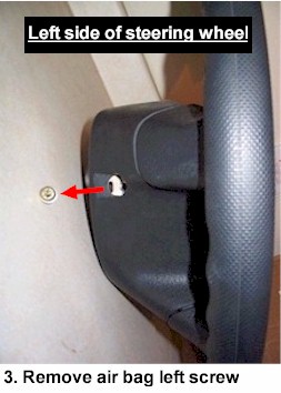

Name:	03 momo install (airbag removal left screw).jpg

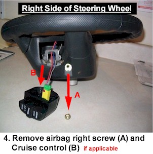

Name:	04 momo install (airbag removal right screw and cruise).jpg

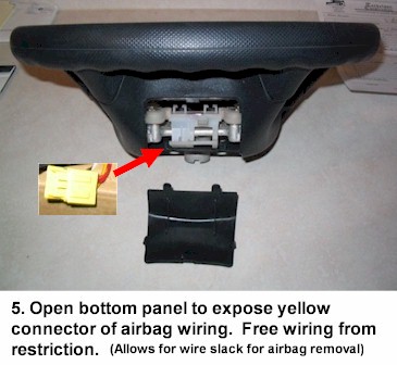

Name:	05 momo install (airbag removal bottom panel).jpg

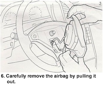

Name:	06 momo install (remove airbag).jpg

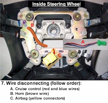

Old Aug 21, 2003
Posts: 1,156
Name:	07 momo install (disconnecting wiring).jpg

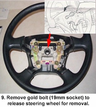

Old Aug 21, 2003
Posts: 1,156
Name:	09 momo install (removal of steering wheel bolt).jpg

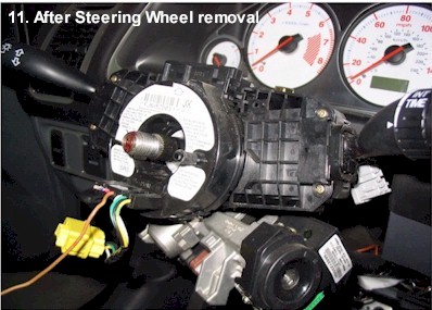

Old Aug 21, 2003
Posts: 1,156
Name:	10 momo install (remove steering wheel).jpg

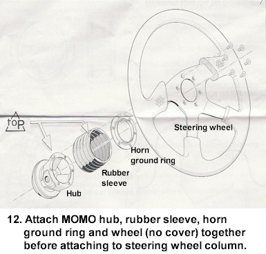

Name:	12 momo install (order of wheel attachment).jpg

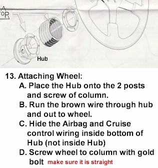

Old Aug 21, 2003
Posts: 1,156
#14 & 15
Name:	14 &15 momo install (testing wheel alignment).jpg
Old Aug 21, 2003
Posts: 1,156

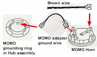

#16 Attaching MOMO Horn
Name:	16 momo install (horn).jpg

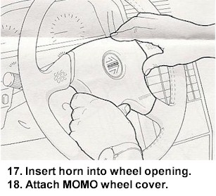

Old Aug 21, 2003
Posts: 1,156
#17 & 18
Name:	17 momo install (install momo steering wheel cover).jpg
Old Aug 21, 2003
Posts: 1,156

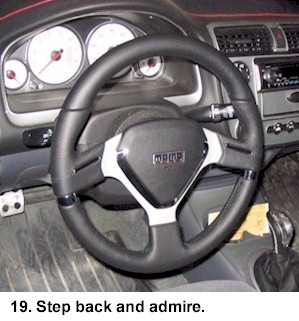

Name:	18 momo install (finished).jpg

THANK YOU SO MUCH!!!! Was kinda worried about the airbag, time to order the momo millenium evo! The law states that it is illegal to resale the car without the airbag be reinstalled right? So its legal to change steering wheel? Where can find this info? Also, do you lose your cruise control, or can you mount the controls elsewhere and keep the cruise control function?

What about the SRS light? Did you have to have it reset or anything?
Old Sep 11, 2003
skipbarber's Avatar
Posts: 4,248
From: Rockville, Maryland
Rep Power: 331
you shouldnt have to if you unplugged the battery for atleast 10 minutes.
