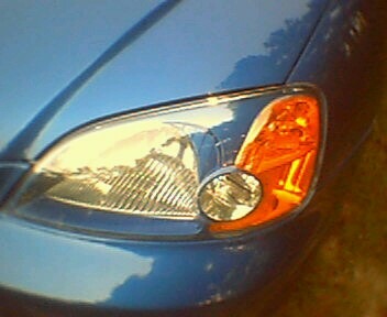

you should have just searched instead of posting a new topic. However, while you have them apart you could paint them too. Results look like this .....

cryption: painted his lights? I can't really tell. What color were they painted? It looks kinda shadowed. Is that the intention?

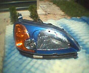

or like this....
Name:	my blue car headlights.jpg
Old Aug 24, 2003
ericscorpse's Avatar
Posts: 185
From: channelview, texas
ericscorpse is an unknown quantity at this point
Originally posted by ericscorpse
or like this....
or this...k, so mine are not cleared but they are painted which I think looks nice

and now to actually help a little bit...after they are removed I popped off the little metal clips....these are very obvious. I used a small flat tip screw driver to seperate the lens from the light assembly (just be gentle), after I painted the junk I just slapped them back together and there was enough sealer left from before to seal them again. I have been through 4 or 5 very hard rains recently and no leakage problems at all.
