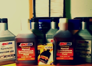

I am changing the oil in my 03' Civic DX MT 1.7L D17A1
For engine oil im using AMSOIL 100% Synthetic 0W-20 motor oil which I have no doubts about. For the manual transmission I purchased AMSOIL's Synthetic Manual Synchromesh Transmission Fluid SAE 5W-30(recommended by amsoil website)
Question: I have heard many mixed reviews about this sychromesh fluid from amsoil most raving about how smooth it makes shifting and some informing that it is not good for the transmission and to only use Honda MTF. Since there are no close Honda dealerships nearby and thats the only place selling their MTF. I chose the Amsoil based on the consensus of many civic owners praising the product and because I'm not one to fall for the manufacturer's biased claims upselling products that keep the consumer's money in the hands only of the Honda corp. Will Amsoil synchromesh MTF work well in my civic? Or is Honda in the right when they say "Do Not Use any other manual transmission fluid"
Attached is an image of the oil purchased. Need help Please, Thanks in advance.

shouldve gone with 5w30 or at least 0w30 for engine oil. 20 weight is too thin esp if you drive where its over freezing.

Get Redline MTF for your Civic if you go synthetic. I've heard of Amsoil eating up synchros after a few hundred miles. Hondas are picky when it comes to fluids and Redline seems to be the only compatible one. As for motor oil, I'd go with gearbox's advice. The one you chose seems too thin.

Anyways I have heard many referrals to the Red Line MTF, yet never actually seen it for sale in any local autoshops, must be too expensive for the average Joe where the shops make most of their sales. Amsoil isnt cheap either for $11 a quart for their MTF. There must be atleast someone who has had experience with this oil in their civics.

Looks like I'll be holding off on the transmission oil change until i have gathered more info on this Amsoil synch. MTF. Just wanted to replace the fluids throughout vehicle as I purchased it not even a week ago used with 89,000 mi. The engine oil is still maple syrup colored but I want the peace of mind knowing that it has the correct oil and how long its been in there etc. If anyone here finds anything out about this said Amsoil MTF please enlighten me, it would be greatly appreciated.

89,000 miles is getting a bit late to change to a full synthetic like the full synthetic extended drain Amsoil or Mobil 1. The extended drain oils are PAO or Ester based and they can dissolve a lot of sludge and varnish left behind from dino oils. Grit that was held in sludge will start to circulate and that can clog filters and ruin bearings.
If your engine is really clean and sludge free, you shouldn't have any of those problems. If it is not clean, then use the 5,000 mile oils, Amsoil, Mobil 1, or any other brand you want. They are not full synthetics and will not be as likely to dissolve the sludge to quickly.
Varnish from dino oil coats the seals over time. Doing engine flushes, or using full synthetics, will clean off the varnish over time. If the seals are dried out, hardened, cracked to begin with, cleaning the varnish off may cause leaks.
I suspect the same problems occur in the transmissions. Amsoil dissolves all the varnish left behind by the dino oil and then the new Amsoil gets contaminated so bad the tranny fails.
If you insist on swithing to Amsoil, 15,000 mile Mobil 1, or other full synthetic, your only defense is to do several oil and filter changes in quick succession to minimize the risk. How quick is your guess. Amsoil also recommends use of their oil flush in the engine before draining the oil out.
Check on Amsoil's website and make sure to get the correct tranny fluid they recommend for your car. There are several different kinds available. They also have a free tech service line to answer questions. But they only make "official" recommendations, which changing to 5w - 30 in the engine isn't.
I would definitely switch to 5w - 30 oil, regardless if you choose dino or synthetic.

Manual tranny fluid has nothing to do with the clutch. Unless the seal is bad and leaks fluid onto the clutch. If the car is new and low miles you should not have problems switching to full synthetic if you make sure to get the fluid recommended by Amsoil for your car. The older and more miles you have, the better to stick with non-synthetic oils.
I just realized you already have 89,000 miles. I would not use Amsoil or any other full synthetic. It's too late.

I put Redline into my car at 130,000 miles with no side effects. You shouldn't have anything to worry about unless the transmission is already messed up. You may benefit from the Amsoil in colder months. That's where I noticed the biggest change in changing gears. It seems like the Honda stuff took longer to warm up.

My d16Y7 has 200k miles on the ticker, its still going strong, just put in Amsoil MTF in, and I can assure you INSTANT smoother shifting that gets even better after a few days, yes the Amsoil might clean a lot of sludge out fast and in turn make the fluid bad, just check it when you change your oil next after like 3k miles on the fluid, check to see if its chunky or not, if its not, put it back in, keep going..
The amsoil cured almost all of the shifting notchy feel, except for when you go for 5th gear, which i suspect is just my linkage being worn, and the cold weather shifting is REALLY improved, it was down to 5 degrees once after I had it in, before it wouldn't go into reverse cold, now it does... The increased cold weather shifting is where Amsoil really shines, but a worn transmission is just an old transmission and is to be expected...
If you live in a cold state, its defiantly worth trying..
