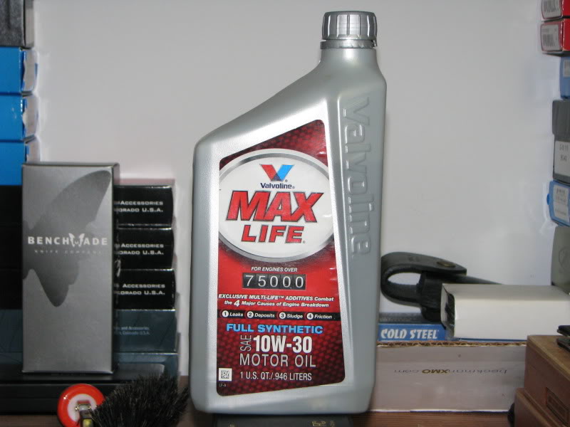

my rule is stick with 5w20 year around if summers dont get hotter than 65-70F unless you dont drive much in the summer or only do mild city driving. hotter than that, switch to 5w30. also castrol is good, but valvoline maxlife is a better hi mileage oil. you could also get away with running 5w30 year around if you use the full synthetic maxlife. 5w20 was really only used for slight gas mileage improvements. the engine runs better on 5w30. add some LC20 additive from lubecontrol.com and you can easily go 10k miles on a single oil change. sample image:
