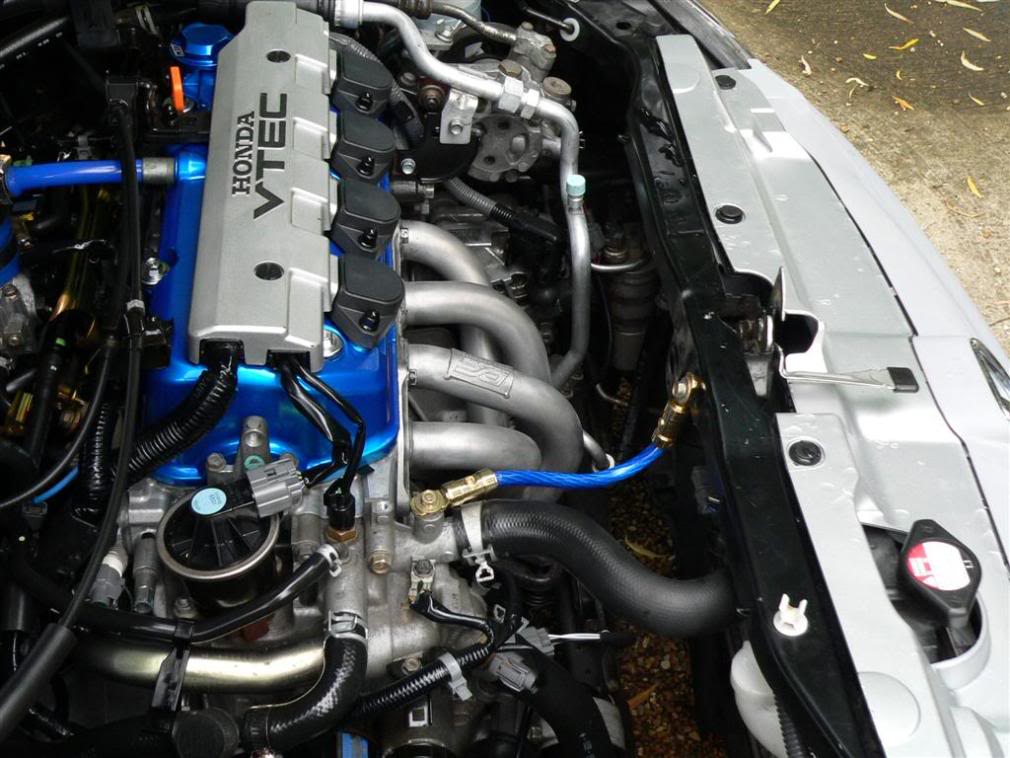

Has anybody used the Prestone Flush 'N Fill kit on there civic? I just got one, but im unsure of which hose im supposed to connect the "T" to for the Garden hose. I really want to back Flush my system. If some one has done it could you mabe take a picure of it. so i can see where you put it. I think i know which one it is. but i dont like to mess with things unless im 100% sure.

They're fine. Here is where I put my tee fitting on the hose coming off the water neck. Look at the bottom left of the picture.

Thanks for your help. but my engine is different than yours. And not as shiny. lol. Here are 2 pics for you to see. [IMG][/IMG] [IMG][/IMG]
can you see which hose it is?

lol your engine IS the same as his they are both D17s just his is... flashy.

Oh. thanks. lol. so do i need to take off that big black plastic cover to expost those hoses?

yeah thats the air intake resonator box. all that unbolts and then you can reach the hoses. make sure you can put it back on with the T installed. may not be enough space.
