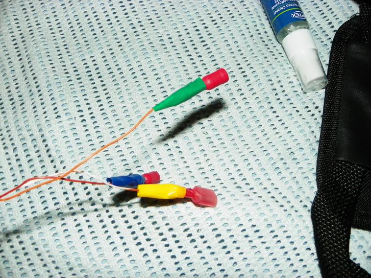

To tap in these wires, you will need to buy some pins from electronic store. The pins I used are 14.9mm overall length with 1.01 mm pin diameter. Crimping tools for these pins is highly recommend to purchase. It will directly effect the reliability of your connection.
Upon you complete crimping Pins on the harness (attached pic 1), you can insert your pins into the desire connector slot. After you put all pins in, your tachometer should have been parasitically attached onto the host circuit and should be able to be reomved as you will. When you done your continuity check and instrument test. You should be good to put everything back together and enjoy your tach. The harness come with my tach is not long enough, therefore I need to crimp some extra connector to extend the legnth of the harness (attached pic 2). It turn out this increase the maintainability of the new installation in some degree.
Althought the space for the cluster comparment is tight, there is still possibility to fit in few more connector as for better manage the relationship between the parasitic circuit and the host circuit.
