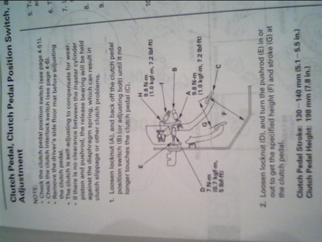

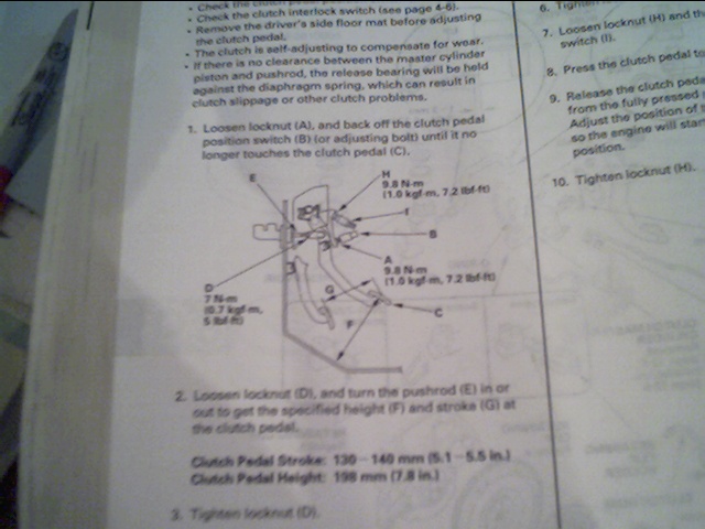

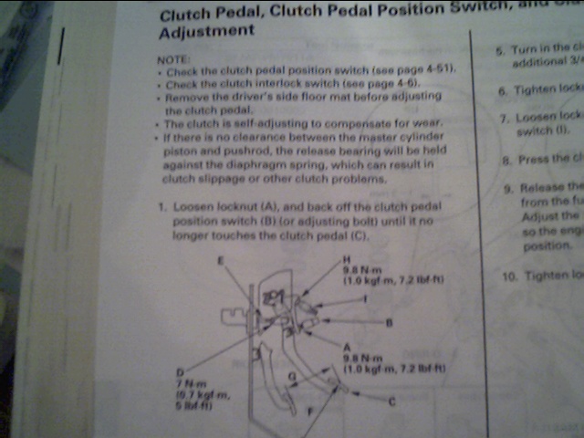

Since I have had several people PM me lately asking me for the clutch pedal adjustment, I thought I would post the information on how to do it. This procedure came directly out of the service manaul.
This DIY will help you if you have a clutch pedal that goes farther down to the floor then normal before the clutch disengages. Also will help if it doesnt engage quite right.
I will leave this thread stickied for awhile just so people know its here or to see it faster, then I will move it to the DIY forum.
Ok to adjust the clutch pedal,
1. if you look up on the top of the clutch pedal, the first thing you should see if a clutch pedal position switch, and right behind it there is a locknut, looens the locknut. once you loosen it, back off on the pedal position switch or adjusting bolt untill it no longer touches the clutch pedal.
2. now behind the clutch pedal, there is a pushrod. and on that pushrod, there is a locknut, loosen that locknut. Now turn the pushrod in or out to get the specified height and stroke at the clutch pedal.
Clutch pedal stroke: 130-140MM (5.1-5.5 in.)
Clutch pedal height: 198 MM (7.8 in)
Not sure the difference between the stoke and height, Maybe you do and can explain it to me, but either way, you want to adjust freeplay. The freeplay is the amount of push on the clutch pedal to where is starts to have resistance from the top. I have usually been told it should be set at 1 1/2-2 inches of freeplay.
Once you set it, tighten the locknut on the pushrod. With the clutch pedal released, turn in the clutch pedal position switch untill it contacts the clutch pedal. then turn it an additional 3/4 to 1 turn. And tighten the locknut.
Now on top of the clutch pedal switch, there is a clutch interlock switch. Loosen the locknut on that switch. then press the clutch pedal to the floor.
release the clutch pedal 15-20 mm (0.59-0.79 in) from the fully pressed position, and hold it there. adjust the position of the clutch interlock switch so the engine will start with the clutch pedal in this position. then tighten the locknut on that switch.
thats it. Hope this helps everyone.
I added some pics from the service manaul incase you needed to see where each part is or to get an idea of everything.
