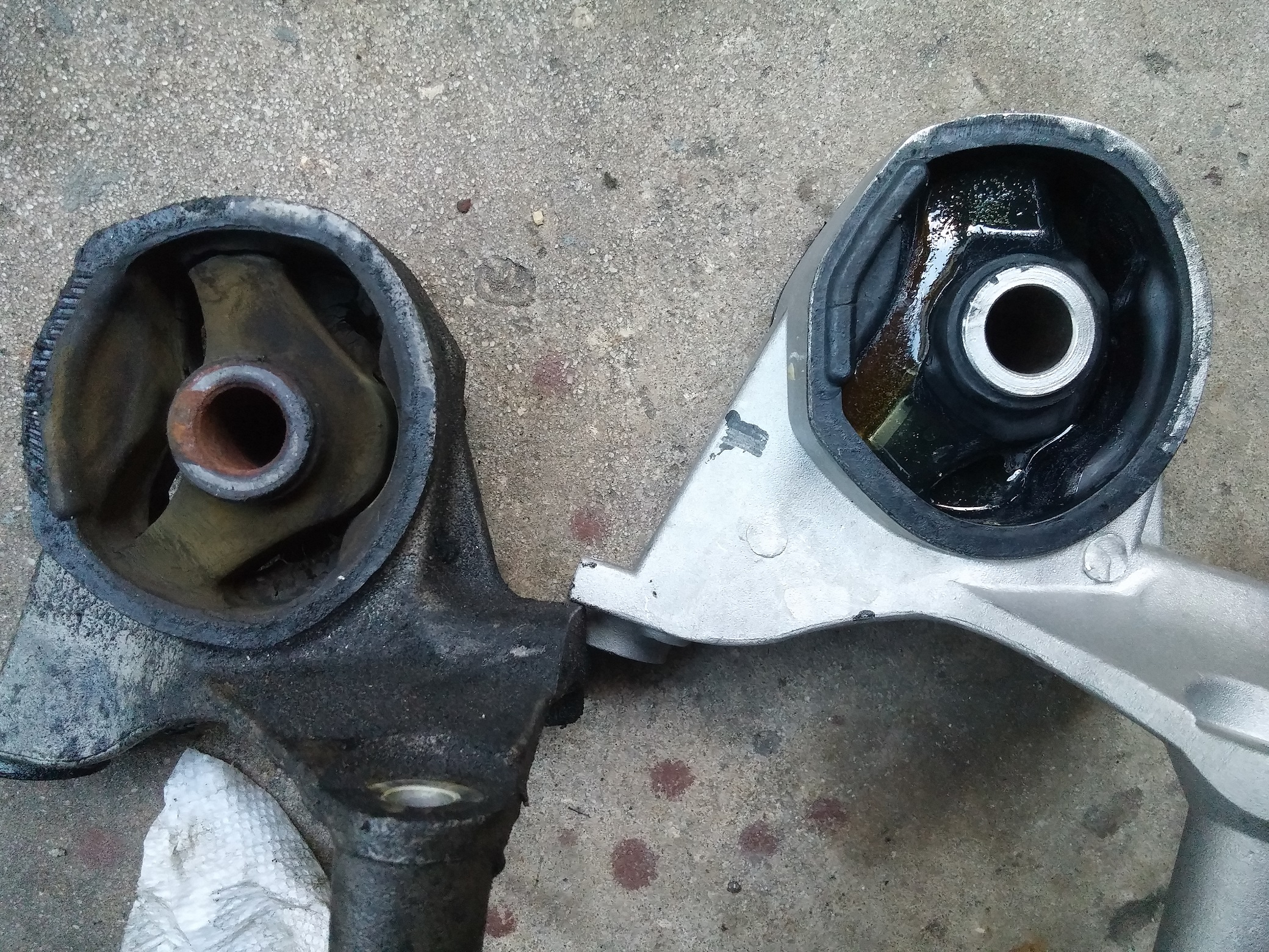

I keep smooth on on speed dial.
and love to add to necromancer posts
Bought this civic as a DD beater, and while correcting the unliveables, took advantage of some new bondable materiel
80duro just a bit of fill
trully regret not packing the **** outta the LCA "bushings"
jesus, whatta mush fest
but,........ DD beater cheap, quick, done

I feel as if there is no final word on this topic?
Would this be a simple solution to stiffen up the LCA bushings? Does anyone have any word as to longevity?

Did this a while ago. Used the flexane 80 and left em solid. They've held up nicely with no issues
