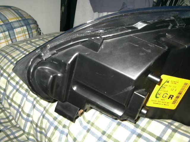

why there isn't any such thing in my coupe headlight?!?!

the headlight he used for DIY is an aftermarket Headlight .... i used to have the same one
for OEM, i think you can only adjust the up and down ... and i do not know how to adjust for left and right

My headlights are the same OEM stock housings that came from the factory. If you look at the pictures you'll notice the horrible re-chaulking job after I've opened them up twice. Once for clearing and another for blacked out housings.
I have a Sedan. Maybe Coupe owners have it different. It you guys do then sorry, I guess this doesn't really apply to you guys.
For the guy that asked about the plastic bolt: I had the same plastic covers. I ripped them out. You can do the same. Wait, you said you had a coupe. Then I'm not sure.

If there's a white plastic piece covering the gear for the left/right adjustment, then you have to take out the headlight and pull it off...I learned that the extra hard way (melted it in the oven, then tried to pry it off...almost broke the damn thing.).
