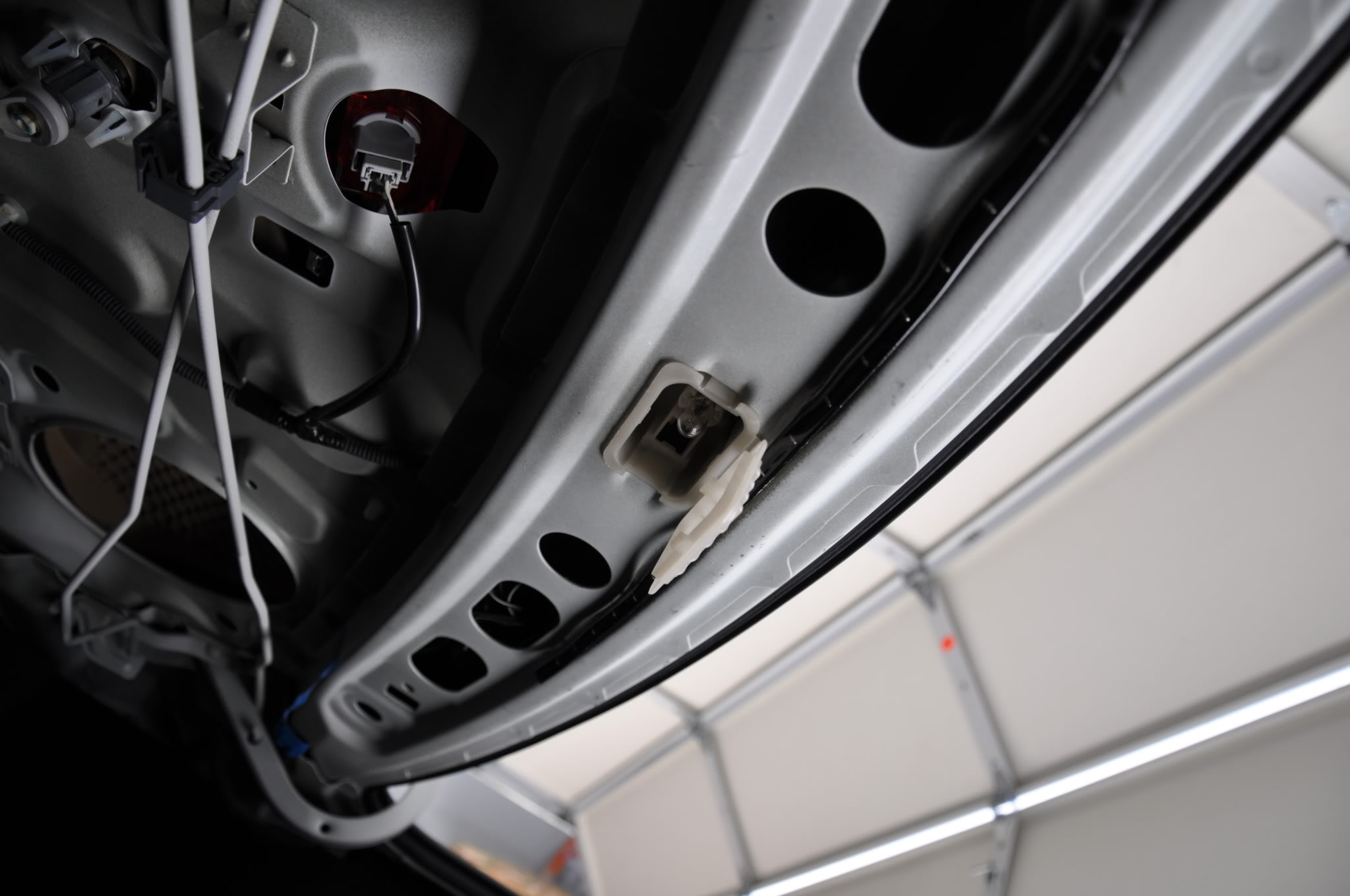

First off, you're going to want to remove the little "cage" that they hold the trunk light in
The way to do this, is either by hand, or a small flathead to pry it out if it doesnt budge
Be kind to it, even though you dont need it, you don't want to break it either

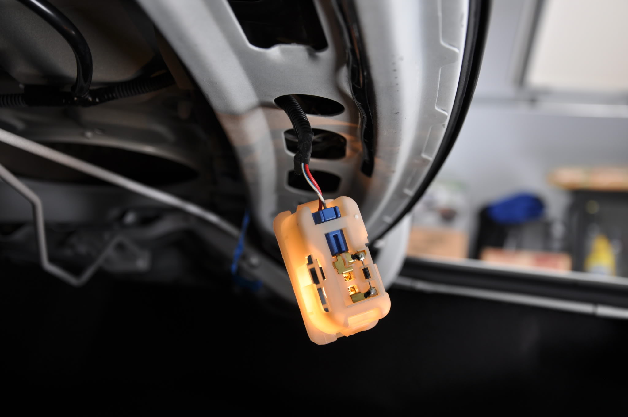

After you've removed the cage, you're going to want to disconnect the blue clip.
Old Aug 6, 2011
  #47
civicchick2001's Avatar
CivicChick2001
Joined: May 2011
Posts: 718
Rep Power: 192
civicchick2001 is a name known to allcivicchick2001 is a name known to allcivicchick2001 is a name known to allcivicchick2001 is a name known to allcivicchick2001 is a name known to allcivicchick2001 is a name known to allcivicchick2001 is a name known to all
Re: Custom Trunk Lid Liner Project
k, its hangin out.. lol
Old Aug 6, 2011
  #48
Kennykid2002's Avatar
Kenny the Ricer
Joined: Oct 2009
Posts: 5,580
From: In your trunk
Once you've removed the blue clip,
You should notice that behind the harness is two wires
One is red, the other is White/Green
The red should be the NEG
And the White/Green should be the POS
Keep that in mind

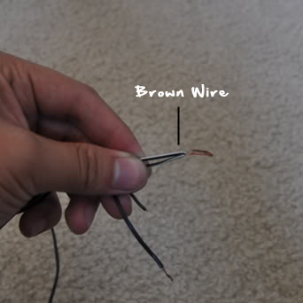

Take the wiring end of your LED and pull the two wires apart somewhat
You're going to have to strip plastic to expose the wiring (A little more than I did, maybe like 1/2 ~1 inch of wiring. You can strip the wires by carefully with a knife, or scissor, just lightly cut around the wire and pull the plastic)
Lets pretend the Black wire with white stripe is your BROWN wire
Do this to both your LEDs

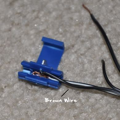

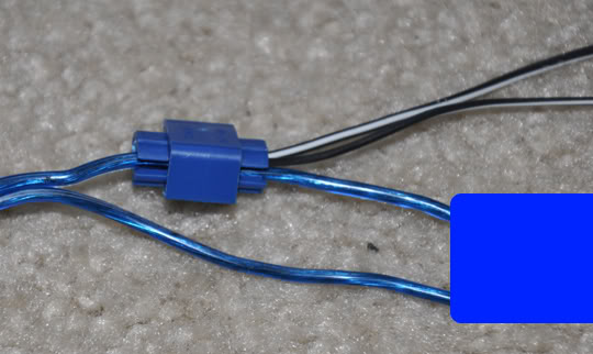

Now that you've done it to both your LED's, You're going to want to combine the two LEDs together, just twist the two BROWN exposed wires together from each LED.
Since your wiring is probably really thin, you probably want to fold it on itself once,twice, or maybe 3 times to get a nice thick chunk of wiring
Do the same for the SILVER wires.

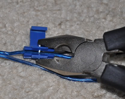

Now that you've combined your LEDs, heres the messy part where you have to climb in your trunk, and dont have a lot of room to work with.
First thing you want to do is take one of the squeeze connectors, and fit the BROWN wiring towards the back (the one that doesnt go through)
You might want to take some pliers and squeeze it down just to test if your wiring is thick enough to keep it still. if not, you might need to fold the wiring a couple more times to get enough wire to keep it from coming out. You can always open up the squeeze connector again.
Once you know it's a tight fit, and wont fall out, you're gonna have to climb into your trunk and do this all at once, so pay attention
You're gonna put the BROWN wiring in the back, like in the last step, and in the front of the squeeze connector, you're gonna have to put the White/Green wire inside of it. and clamp down tight.

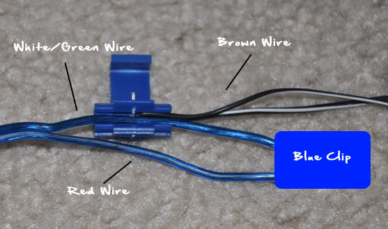

Once you did that successfully, it should look something similar to this
Then just do the same with the SILVER wire
