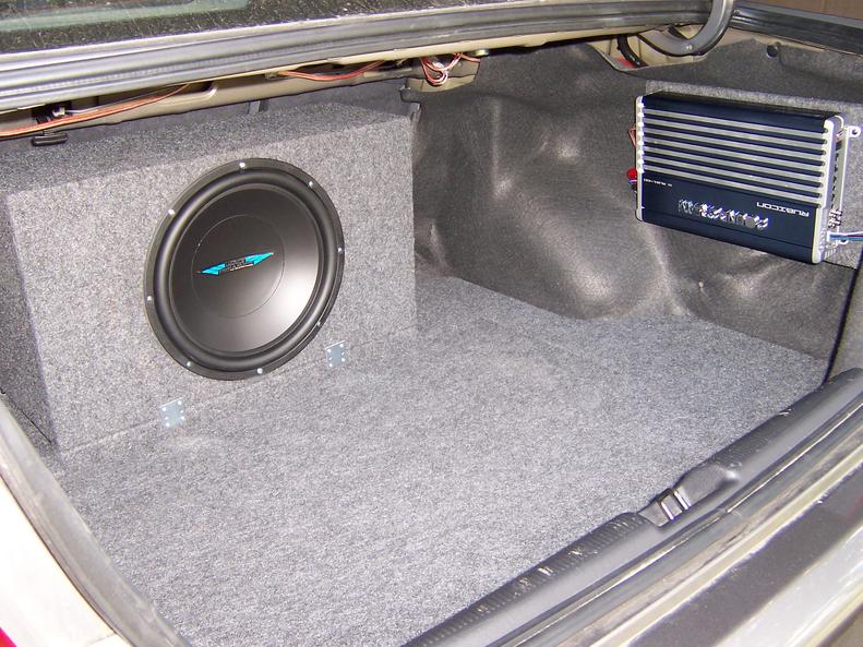

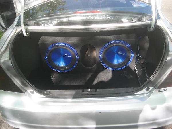

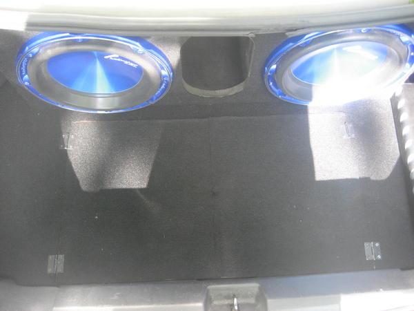

Might as well keep this thread going... Great tutorial. Got my custom trunk now, with sub and amp in place, looks nice and clean. Thanks for posting the DIY!

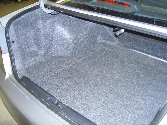

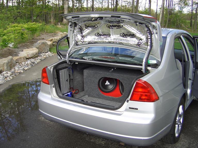

I tried this with my trunk but did a couple things diff.

Yeah that's a nice twist, the way the doors open up. Can you get to your spare still?
I forgot to mention, I didn't end up putting hinges on mine, so the panel just lifts up to get to the spare. I only used 3/4" MDF on the part holding the sub box. The rest of it is 1/2" OSB. I didn't really think i need the extra strength/weight of MDF, plus I had enough OSB laying around. I used some felt that picked up from the craft store @ $5/yard, so this was a really cheap DIY. I also used a thin board to rest the front of the sub box on so it would sit more level since the back of the sub box is resting on that raised strip of metal where the back seats meet the trunk floor. You should see how bowed the OEM board is that I removed! POS

Yup the wheel is still accessible, just got to remove the other stuff and there is just enough room to stick my arm in to unscrew the wheel and pull it out. I used all 1/2in. MDF and it seems to be holdin up great. I wanted to mount my amp on the right side but couldnt figure out a way for it to work right. I'm happy with how it is tho

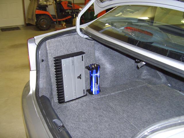

I did pretty much the same thing, adding an amp holder under the floor:
By mkkuntz8 at 2011-05-21
Had to cut modify the plastic part a little to give the amp rack room to go up and down

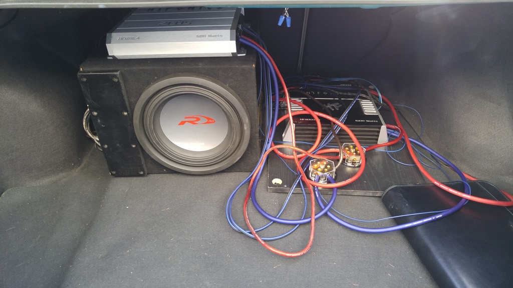

My attempt this past weekend, based off your 'inspiration', diskreet.
Before:
After:
