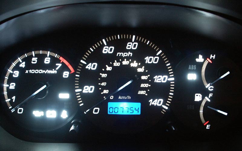

The goal of this DIY is to help the user change the lights in their car to color for the backlight, and any color they want for the icons (left/right turn etc...).
Also the ability to change the faces with photoshop etc... is an option, a large full color scanned is provided, don't download it unless you're really going to work with it in photoshop, as the bandwidth is expensive at with a 5 meg file. The other pictures provided should suffice for reference.
Obviously the user can change stuff around, this is just how I changed my gauges, color and number of bulbs can be swapped out for certain uses.

8) put everything back together and "manuever" the LEDs
Like above, put the white piece that deflects the Light ontop of the PCB. You'll have to fit each of the LEDs into the original hole, and then make sure before you put everything back together that none of the wires are crossing (if you have multiple LEDs wired together for the backlights). Pic 24 is the white plastic light diffuser piece with the LEDs pushed through the holes. spread the LEDs out as best you can without them shorting each other! Put the face back on and the washers too (remember the flat parts). Don't put the needles on or the clear plastic dome cover on yet, we have to calibrate them first.
9) Calibrating your needles
In order to calibrate your gauges you need a reference point for each item. If you haven't already tested out your gauges by plugging them in and turning your car to the knotch right before ignition. Turn the lights on, play with it etc... make sure it works before you calibrate your needles and go for a drive (or you'll have to get another full tank).
Ok, if you haven't already, plug in your gauges (blue and green) and just set them in their place in the dash. Turn the key to right before you start the car... If you had the needles on, they would jump up to like 2,000 rpm, 30mph etc... SO...
Your car is hopefully cool (it must be cool!) and not running, so just place the tach needle at 0RPM. The SPEDO needle at 0MPH, the Full Gas needle on FULL (because you HAVE a full tank). and the temp needle just below full cold.
Now turn your car on, and take a drive, make sure everything works, and pop the clear plastic dome on, screws etc... back together. Whala. Done.
I've attached a full sized scan of the gauge faces in JPG format 100% compression. Should be good enough for anyone to edit, or I have a 3 meg tif if anyone wants to work on a new gauge face in photoshop. You can get in touch with me through my profile.
Enjoy, and lemme know who's actually completed this! Ocelaris

In the end I used strings of SMD LEDs wired to the bulb solder tabs. I used 3 SMD white with a 200ohm resistor (or thereabouts I forget the exact amount). I used 24 total behind my face, and replaced all the twist on bulbs with a 3 or 5mm LED with a resistor in series.
Here is what my gauges look like now.
You can take the general advice for this and apply it to any light bulb in your car.
