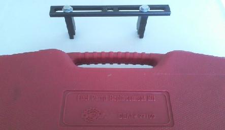

One thing I do recommend to do is to lube the new O-Rings with oil to get them to fit correctly since they go on tight. This is really easy to do. Just take your time and follow my pictures.
