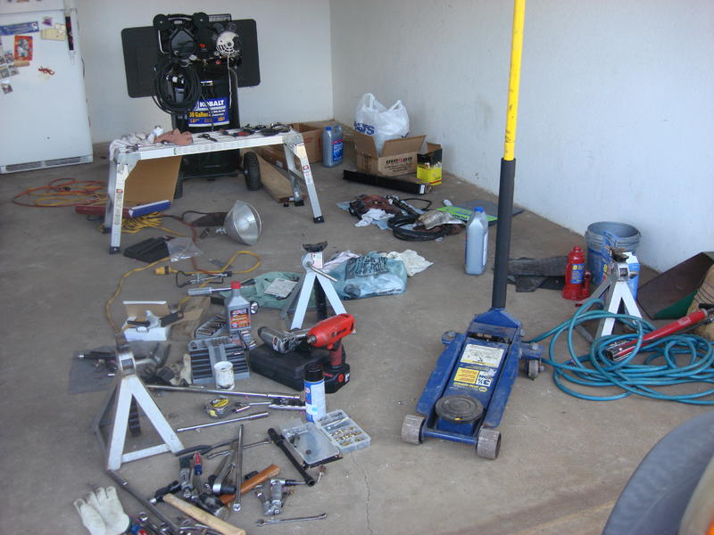

Needless to say, it’s important to lay out parts in an orderly fashion as they are removed from the car. It’s very frustrating to replace a part and then discover you skipped a step. I know. I installed the crankshaft pulley and the DAMN pulley bolt and then realized I had NOT installed the lower timing belt pulley cover. I had to remove the dreaded crankshaft pulley bolt AGAIN. I must say, it’s much easier the second time! I also like to use numbered sandwich bags to store nuts, bolts, etc that are removed from the car. The bags reduce the confusion and help prevent lost items.
I wrote this DIY because I found myself flipping between Reddawnman’s DIY, the Haynes Manual, and the Civic Manual. I also found that it was easy to skip a step when using multiple manuals as outlined in the previous paragraph. This DIY is an attempt to compile the knowledge from all 3 sources plus my own personal experiences doing this job. Hopefully, the extra details will make life easier for others. Good luck to anyone who decides to tackle this job.

Tools:
Metric socket set and wrenches. 10, 12, 14, and 17 mm are the main sockets
Deep sockets are helpful for a few bolts
Various adapters and extensions for sockets.
Combination wrenches (box and open end)
Pliers
19 mm impact socket for crankshaft bolt (1/2 inch drive or bigger)
20” extension to loosen crankshaft bolt (1/2 inch drive or bigger)
2 breaker bars (1/2 inch drive or bigger)
Torque wrench
2.5 mm allen wrench or heavy duty wire to act as a “grenade pin” on the tensioner.
Wire brush
Rubber hammer OR regular hammer and block of wood to loosen valve cover.
Belt wrench or screwdriver if you plan to remove the camshaft pulley

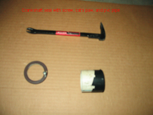

Electric drill, drill bit, screw driver, and cat’s paw if you plan to replace crankshaft seal.
V-belt tension gauge (kragens, auto zone, etc) OR straight edge and ruler if you use the low tech method.
Jack stands to support the front end of the car (2)
Jack stand to use while loosening the crankshaft bolt
Hydraulic jack
Pan to drain coolant
1.5 inch diameter pvc pipe to insert seals
Trouble light
Rags and newspapers to clean up spilled coolant

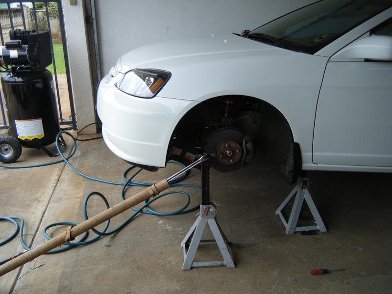

The most difficult job is loosening the crankshaft pulley bolt. I therefore chose to tackle this job first. If you can’t loosen the crankshaft pulley bolt, then you can’t replace the timing belt so don’t tear apart your car until you successfully loosen the crankshaft pulley bolt.
1. Confirm that you have the anti-theft code for the radio.
2. Write down the frequencies for the preset radio buttons.
3. Disconnect the negative lead of the battery and wrap the cable with rubber or other insulating material.
4. Loosen driver-side lug nuts.
5. Chock the rear wheels.
6. Jack up the front of the car. Jack point is the metal cross-brace behind the radiator. The black colored wind screen below the front of the car is marked to show the jack point.
7. Attach jack stands on both sides of the car. I prefer to use a stack of 2” by 10” by 12” wooden boards because I don’t’ trust jack stands. In this case, I used a stack of seven 2” by 10” by 12” boards behind the driver side wheel well. I also placed one 2” by 10” by 12” under the right front wheel. This arrangement gives me adequate clearance to slide under the car and reduces the back pain when working from above the car.
8. Remove driver side wheel.
9. Loosen and move the splash shield to gain access to the crankshaft pulley. It is not necessary to remove the entire splash shield from the front of the car. Just remove two plastic clips from the splash shield inside the wheel well and then disconnect the interlocking connection between the fender splash shield and the front apron. Once this is done, then gently bend the splash shield out of the way.
Section B: Loosen crankshaft pulley bolt:
Check out this video to see how the 50 mm socket is used with the 19 mm socket. Click on the video in the following web page.
http://www.denlorstools.com/home/dt1...0mm_valve.html
1. Position the special 50 mm socket and a ½ inch diameter breaker bar onto the pulley at about the 7:00 position as shown in the following picture. The length of the breaker bar will vary depending upon the elevation of the pulley. Wedge the breaker bar against the floor or other immovable object. It may be necessary to rotate the crankshaft with a 19 mm socket to get the proper alignment. ONLY ROTATE THE CRANKSHAFT IN A COUNTER CLOCKWISE DIRECTION AS YOU VIEW THE PULLEY. If you can’t rotate the crankshaft, remove the spark plugs and it will be easier to rotate the crankshaft. The following picture was borrowed from Reddawnman’s DIY. I apologize for not taking a picture showing the use of both wrenches but the video listed above shows the technique. The video makes it look easy. Trust me - it’s not.
2. Attach the 19 mm impact socket (1/2 inch or larger drive), 20” extension, and long breaker bar onto the crankshaft bolt. Position a jack stand at the end of the extension to act as a brace. I used a 24 inch long breaker bar and a 4 foot steel pipe for a cheater. The effective length of my lever was 5 feet because I slid the pipe 12 inches over the breaker bar. Even with this arrangement, loosening the bolt was a bitch. I fought the bolt for an hour and stopped because the metal extension was twisting with all the torque. I was fearful of breaking the bolt, my 19 mm socket (non impact at this point), the 20” extension, or my body. I applied Liquid Wrench twice over 30 minutes, let it soak for an hour, and tried again with no luck. I then bought an impact socket (½ inch drive) and 20 inch extension from Sears. My no name brand extension was twisting so much I was afraid it would snap. I eventually removed the bolt. I don’t think the Liquid Wrench helped. You just need to use a lot of muscle power. Even a 160 lb weakling like me can do it with the proper tools. I had a helper push against the end of the breaker bar with a board to reduce the chances of the 19 mm socket from slipping off the bolt. I then used my 5 ft lever and applied an incredible amount of force to the socket and extension. I’m guessing that I had to rotate the lever 30 to 45 degrees before the bolt broke free with a loud snap. The 30 to 45 degree rotation was not due to any movement of the bolt – the metal tools were twisting and/or flexing. HOLY ****. Needless to say, this job is not for the weak of heart. Be prepared for something to snap. I wore safety goggles and threw a blanket over the tools to protect me from flying metal. I had a socket shatter while trying to remove the crankshaft bolt on a Camry so I’m a little gun shy about this stuff. I had flying metal parts on the Camry job. Also position your body so you don’t hurt yourself if/when something breaks. For the record, I was close to giving up on this job. I called the local rental store and asked about a compressor. They said others had tried to remove crankshaft bolts with their compressors with no luck. My next option was the mobile mechanic route. I did not get a price for the mobile mechanic but figured it would not be cheap.
3. When the bolt breaks loose, CELEBRATE. You’ve just completed the most difficult part of this DIY

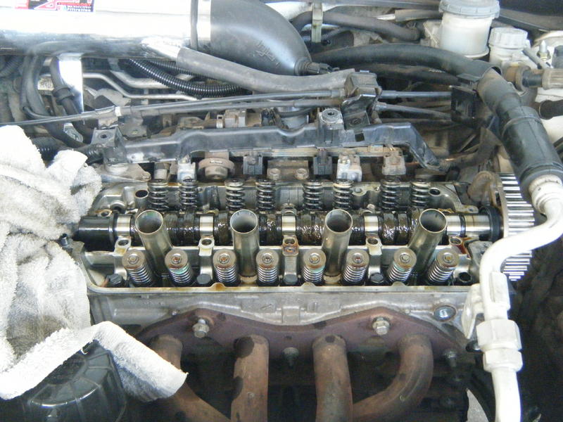

16. Remove the valve cover. Loosen 6 bolts (10 mm). The Haynes Manual says to follow the reserve of the tightening sequence which is attached in Section M. If the valve cover is stuck to the cylinder head, tap the cover with a rubber mallet or block of wood to break the seal. DO NOT PRY BETWEEN THE VALVE COVER AND CYLINDER HEAD OR YOU MAY DAMAGE THE GASKET MATING SURFACE. It will be necessary to gently pull up on the A/C hoses to remove the valve cover. Don’t bend the metal tubing.
17. Inspect the rubber parts associated with the valve cover. Note the location where four blobs of RTV sealant were added to the gasket/cylinder head. Always replace the gasket. The rubber seals on the spark plug tubes and the bolts were in good shape so I reused them.
18. Cover the cylinder head so junk does not fall into it.

3. Note the orientation of the seal relative to the engine block and the crankshaft. My seal was flush with engine block and slightly lower than the wider part of the shaft.
4. All manuals say to remove the seal with a screw driver or metal toothpick device without damaging the sealing surfaces. Good luck with that. It tried that for 2 hours on a camry with zero luck.
5. The following technique was recommended to me by several sources (including an owner of a car repair shop) and it works for me:
6. Carefully drill a small hole in the center of the seal. I typically use a 1/16 inch drill bit. Screw a small sheet metal screw into the hole. You only need to catch 1-2 threads of the screw. Use a cat’s paw (ie tiny pry bar) to gently pry out the seal. I’ve been told that you can use a self tapping screw if you don’t own a drill. I have not tried the technique with the self taping screw.
7. Clean any dirt from the sealing surfaces of the shaft.
8. Lubricate the edges of the seal with oil or multipurpose grease.
9. Position the seal onto the shaft and gently tap the seal into place. I use a hammer, 1.5 inch diameter pvc pipe (the end is covered with electrical tape), and a piece of wood (also covered with electrical tape). The wood can be helpful if the seal starts to go on unevenly.
10. Confirm the seal was not damaged. No tears in seal. Spring did not pop out.

Figured I could post some pics I took to help clarify things:
[IMG]file:///C:/Users/Devin/Desktop/P1280656.jpg[/IMG]First ones are how ya get those spark plug seals out. Just whack the screwdriver as shown with a rubber mallet fairly hard enough to kink it good (and not slip and nail the cover)
Then flip it over and whack the other side. Should pop right out.
Heres one of drilling into the crankshaft seal and screwin in the screw:

Howzit. Well I started late but got some good progress. First I wanted to get the dreaded crank pulley out of the way. Tried with an impact, to no avail. Then tried the method with a long extension extra jack stand, and a long cheater bar, and it broke loose in two shakes. Installed the stage one cam, and header. The header had a rounded nut from a previous attempt to install the header. Had to use a die grinder and a rotary file to get the nut out. Saved the stud and all went well.
Re: 2003 Civic Timing Belt DIY
More pics. Sorry only allow two pics at a time. Stock cam and stage one cam, and the came installed. Couldn't install the rockers because I forgot to get a new rear cam seal. I wanted to get genuine Honda. So I'll get it tomorrow and continue with the valvetrain when I get the seal. The foward seal is seated correctly, in the picture I didn't yet place it in the correct location.

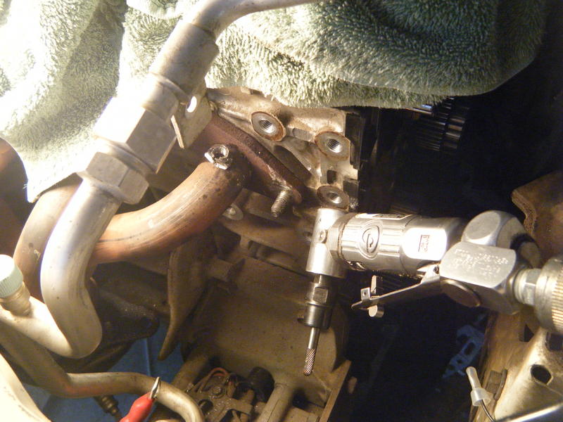

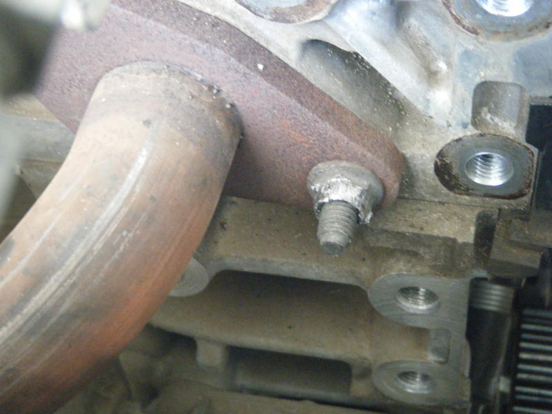

I took my time and carefully cut down the nut with a die grinder and a rotary file, then chiseled off the nut. I managed to save the stud so the header went on with no problems. The rockers and the timing belt as well as the engine mounts are going on tomorrow.

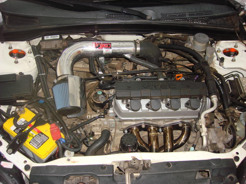

Howzit. Thanks to this forum, I changed my timing belt also at the same time installed a cam header and engine mount.. I just started her up and it didn't blow up, no cel. Shes idling nicely. Going to take her for a test drive and try out the cam. Thanks again. Camera died so no pics yet. Probably a couple of pics of the finished product and the war zone.
Hers some pics of the finished product. All went well untill I installed the front forward mount. I was feeling good about myself because i managed to remove a rounded nut and still save the stud, but on the last thing to do which was the engine mount I stripped the bolt hole. I didn't turn the bolt too far in so I think I can still save the hole and use a tap. Thats going to happen later when the cam breaks in and I'll change the oil. Garage is a mess.
