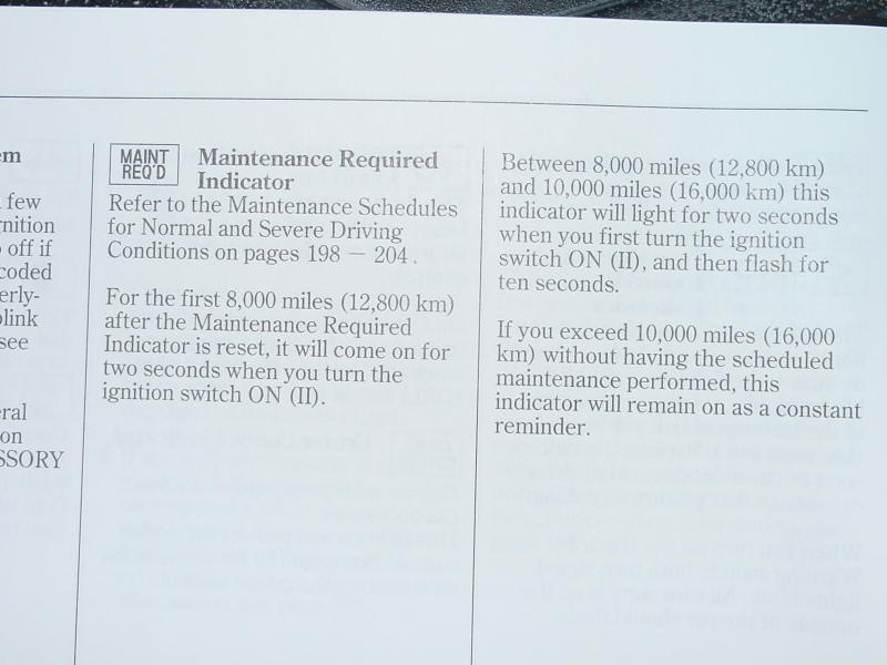

For the people that are too damn lazy to look in the manual here it is.
ID:	87644   Click image for larger version
ID:	87645   Click image for larger version
