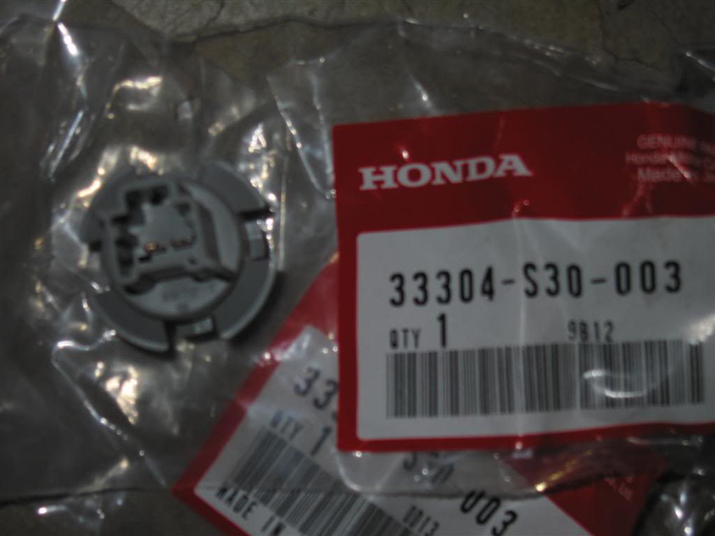

2. Two factory turn signal sockets part # 33304-S30-003 $6.50 each

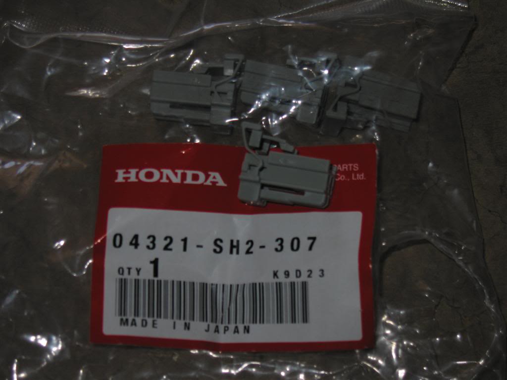

3. One pack of connectors (they come in packs of 5 so only order 1 pack) part # 04321-SH2-307 $4 per pack again only one pack needed

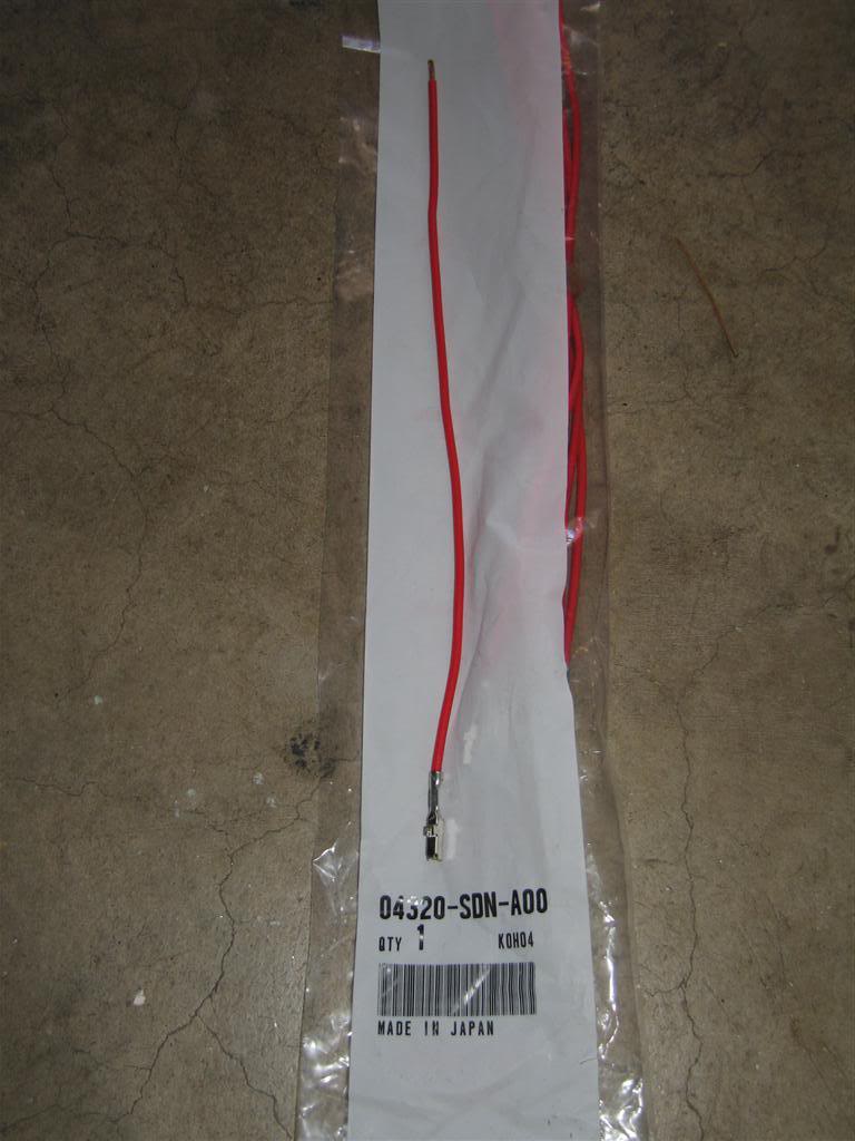

4. One pack of Pigtails (they come in packs of 10 you will only need 4 of them) part # 04320-SDN-A00 $8.00

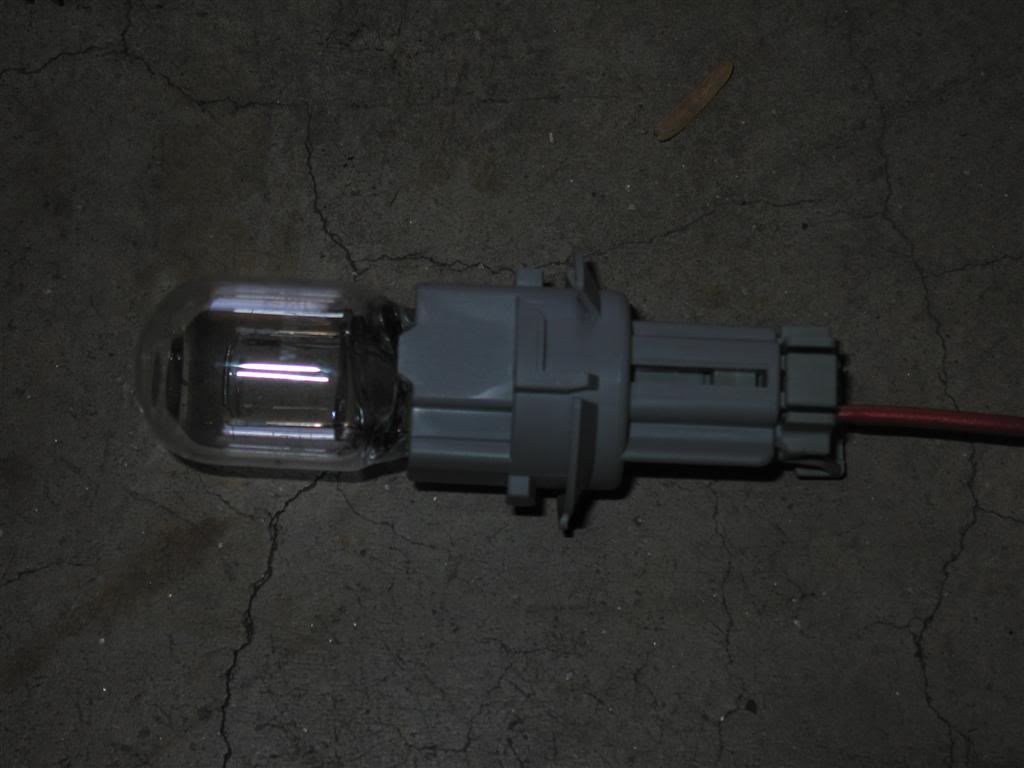

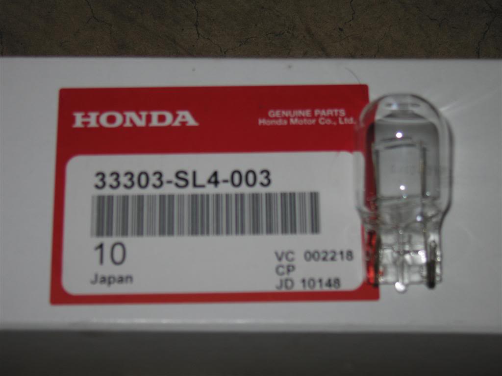

5. Two new signal bulbs Part # 33303-SL4-003

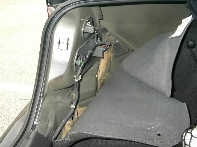

1. Pull the plastic screws holding the trunk carpet and peal it back so that you can get to the backside of the tail lights.

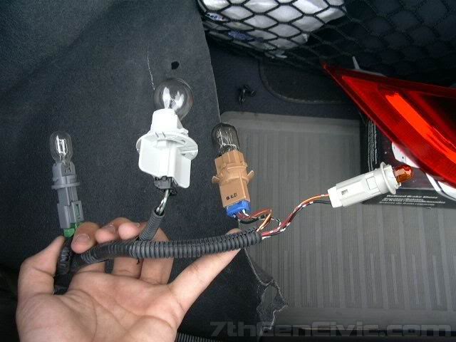

2. Remove all four sockets from the tail light housing.

5. Only three Socket/bulbs are used in the new tails, the one all the way to the right wont be used it's the side marker, remove the socket/bulb from the connector and zip-tie old connector to the harness, I put the old socket/bulb back in the old tails for safe keeping.

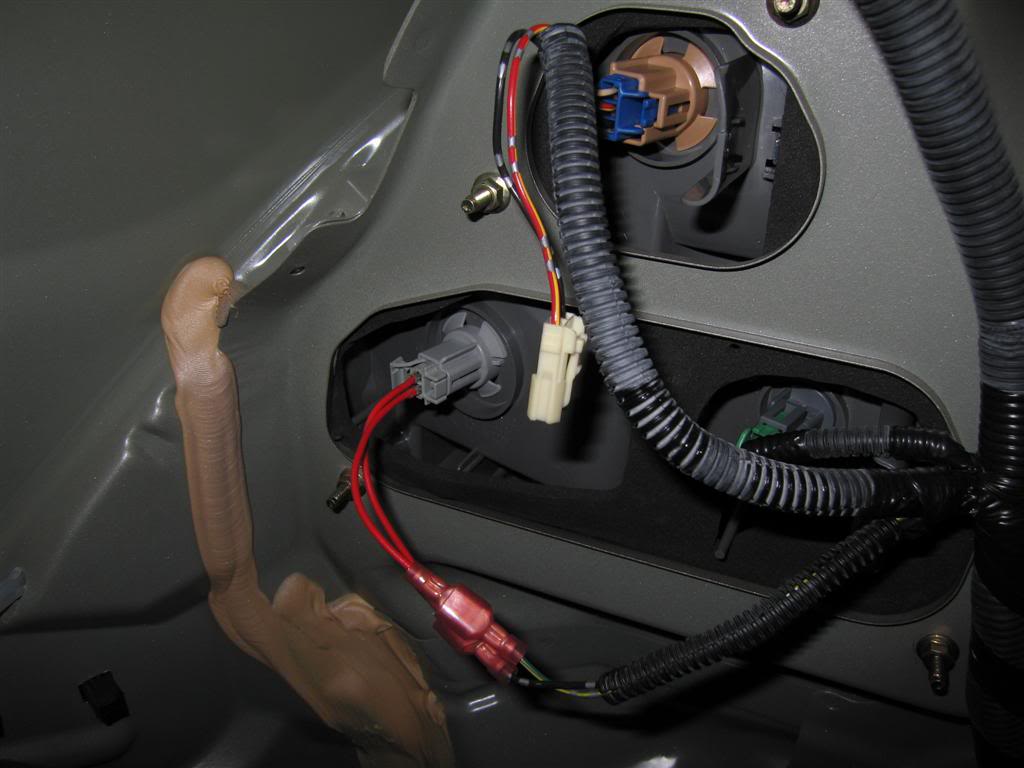

6. Plug in the reverse light & the brake lights into their respective sockets. In the picture the top socket brown with blue connector is the brake/running lights, and the reverse lights are the dark gray socket with the green connector, it's the bottom right in the picture. The new turn socket Light gray socket & Connector (completed in this picture) is bottom left, and the connector hanging is the old side signal connector (not used in the new tails).

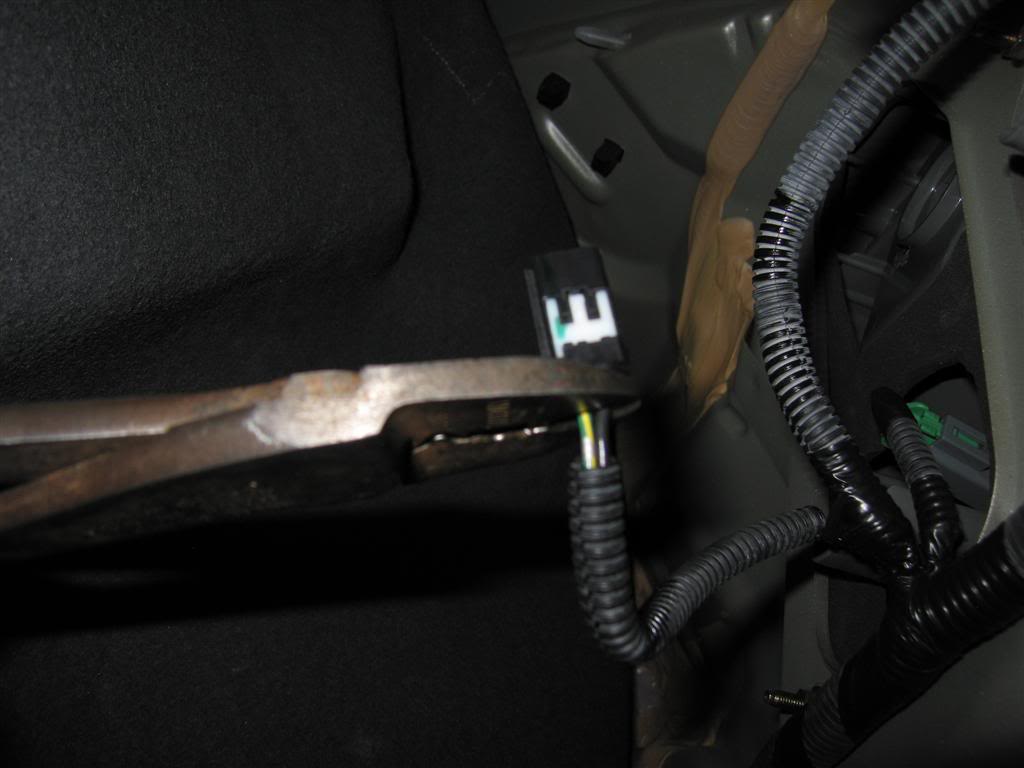

7. Now unplug the black connector from the large signal socket and clip it off about an inch from the connector so you can reuse it if you ever want to put your stock tails back in.

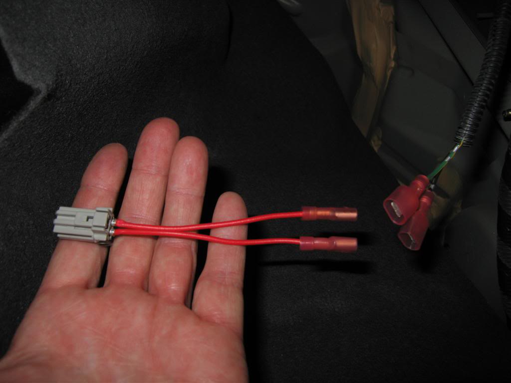

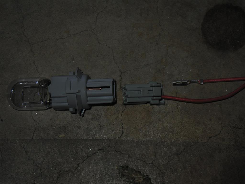

8. Ok it's time to put your new connectors together. Take the new connector and install the new pigtails into them (two each).

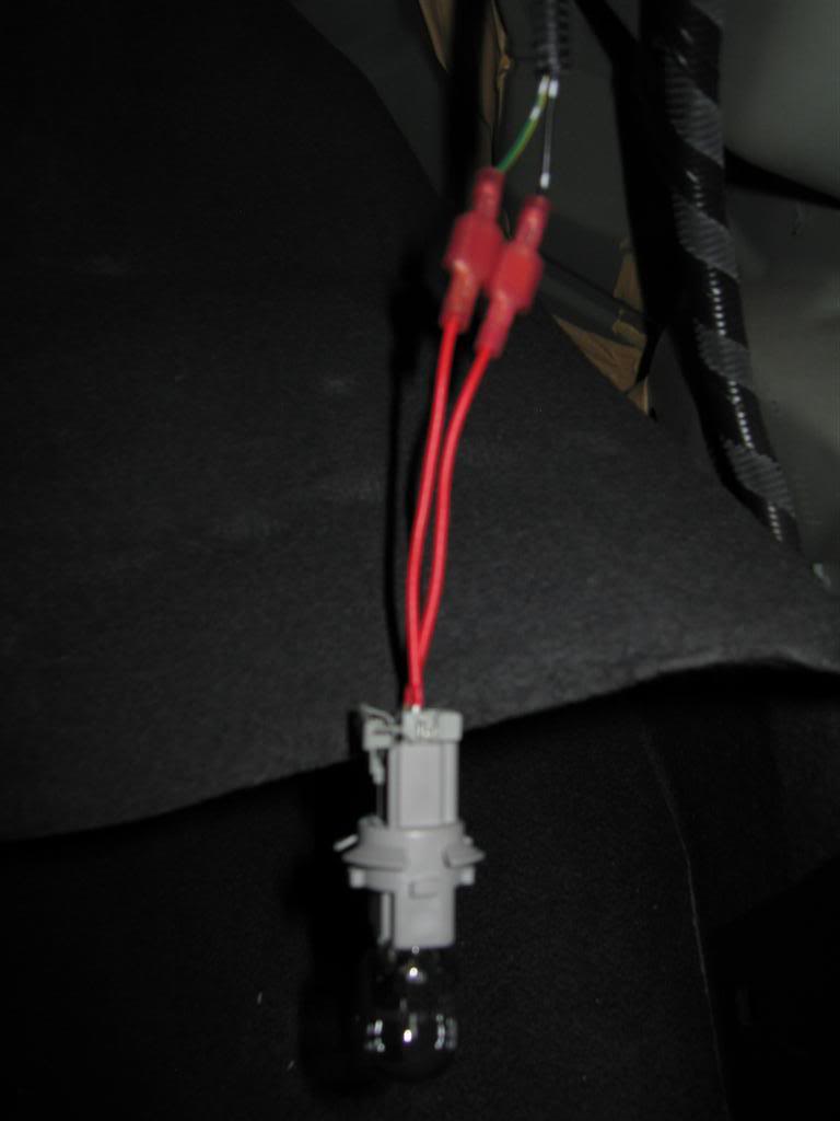

Now simply push the connector into the new socket and install the bulb
9. Use wire connectors or solder the wires to the harness. I chose to use connectors so that I could easily put my stock tails back in down the road either way will work.

This is what your final connection will look like.

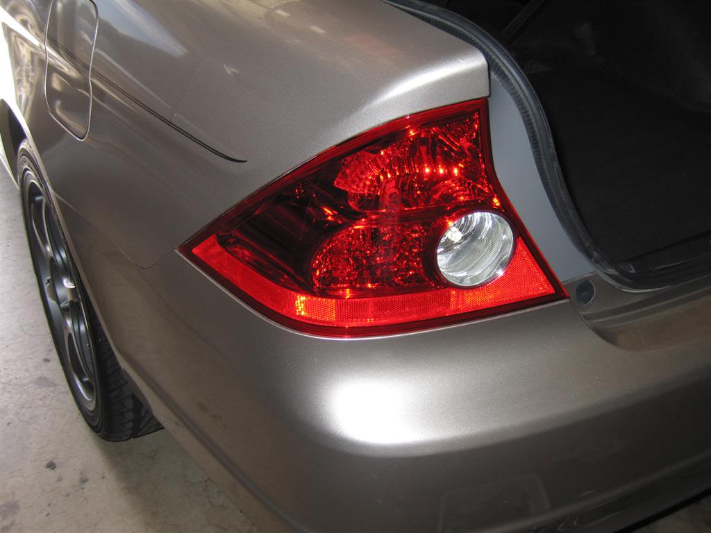

Here is the finished product looks much better IMO.
