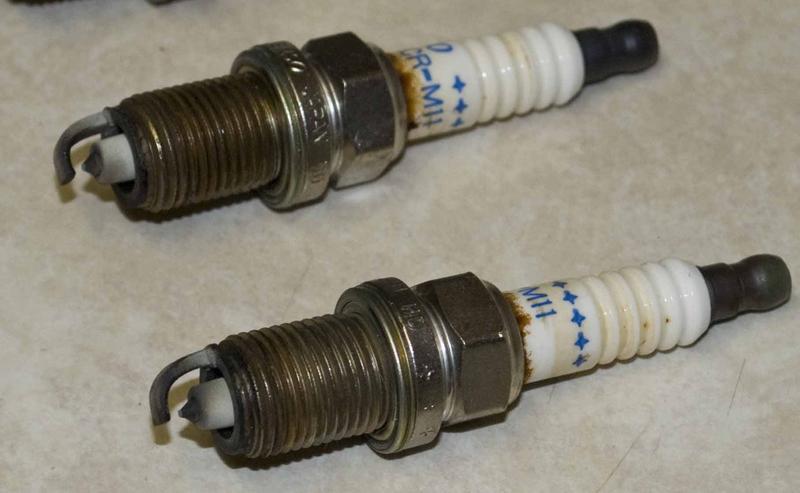

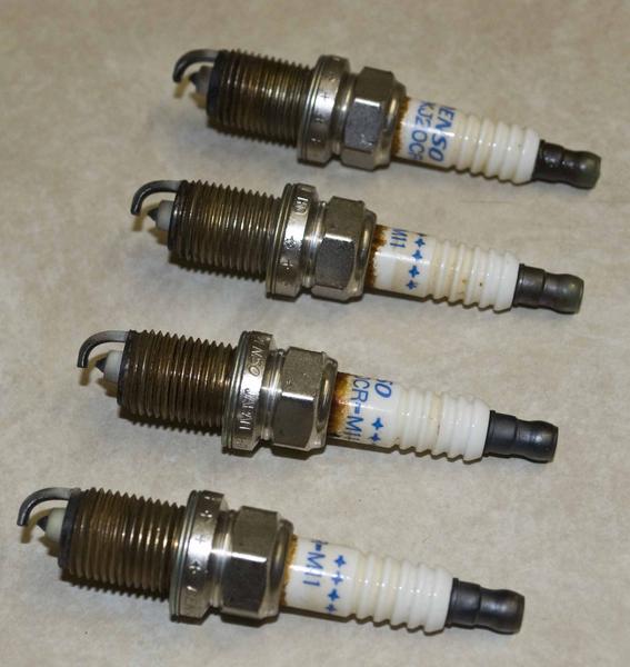

Hi all,
Finally replaced my spark plugs today. Thanks a lot to Gearbox, tbohar and of course LT2004ever for this wonderful post.
I got all the tools and it was a piece of cake and loads of fun. Applied dielectric grease and anti-seize compound on the new ones before attaching. Did not have a torque wrench, so tightened it close to how tight they were while opening (around 1/4 to 5/8 th turn after hand tightening).
Below are picture of the old ones. Does anyone see anything abnormal on the old ones?

lol once again you failed to read the previous post on page 2 " listen to what your spark plugs are telling you".

I read that link and my plugs look good to me...just wanted to double check...coz I frankly do not know much about plugs
