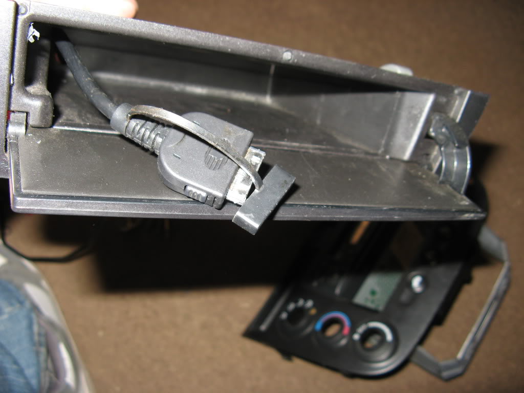

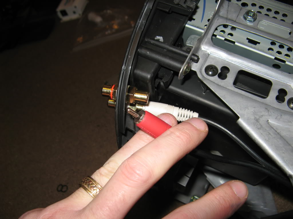

I wanted the iPod cable inside the cash box. You'll need to remove the climate control ***** (just pull on them from the front). The climate control cluster then has a few screws that will remove it from the instrument panel.
Removing the climate control cluster will allow you access to the fourth screw holding the cash box to the instrument/radio assembly. Once the the cash box is removed you can unclip the two halves which will allow it to partially open like a clamshell. This will allow you to slide the iPod cable into the box while leaving a hole big enough for just the cable.

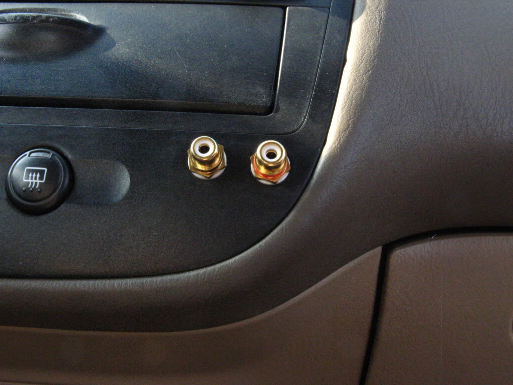

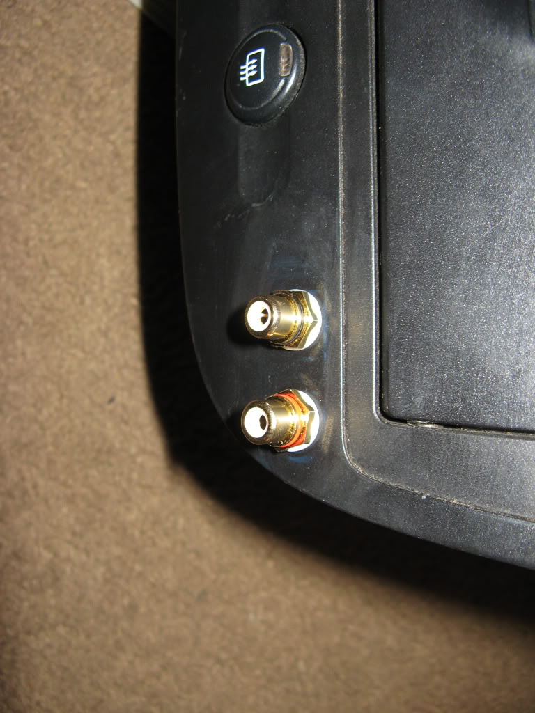

Like I said, I wanted to keep the RCA input functionality but didn't want the cable out all of the time. I bought these panel mount female to female RCA plugs on eBay. This allowed everything to be unplugged if needed and required no soldering. Just unscrew the hardware on the plugs, remove the panel part, drill holes where you want them, and screw them in. Then use male / male RCA plugs to connect them to the PA11-Hon. I installed them up near the climate buttons, but I wish I run them down to the right of the cigarette lighter. Up to you, though.

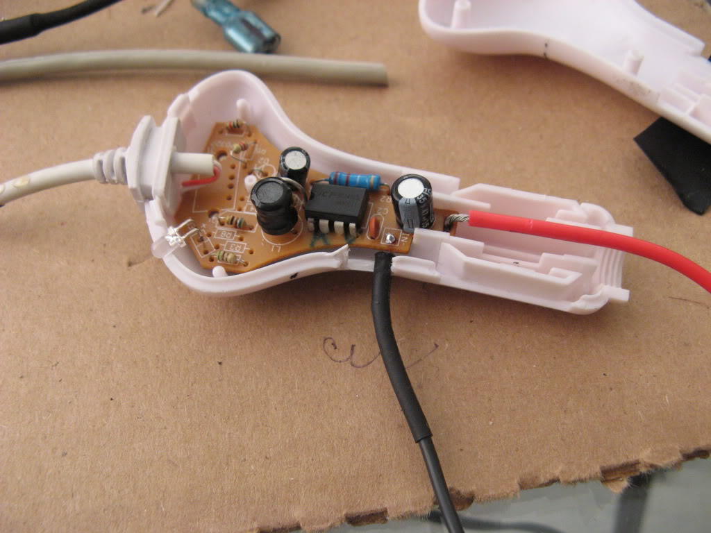

First rip open the charger you're using. Identify the positive input (usually the spring) and the ground (usually attached somehow to the clippy parts on the side). Desolder both from the mainboard and attach your fuse holder and your own ground wire. I made a hole in the side of the housing to allow them space to come out.
Identify the output positive and ground wires. I originally tried to use the existing wires but they were so crappy i ended up desoldering them and soldering in my own. I attached these to small harnesses so that the panel could still be removed after installation.
Here is a shot of the inside and outside of the unit. Disregard the USB cable in the shot -- I ended up not using that one. Also remember the I ended up soldering in my own output wires but you get the idea.

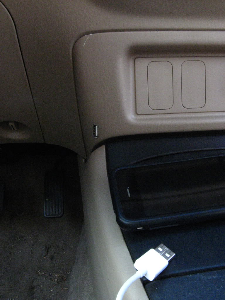

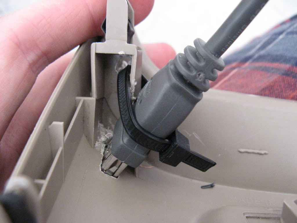

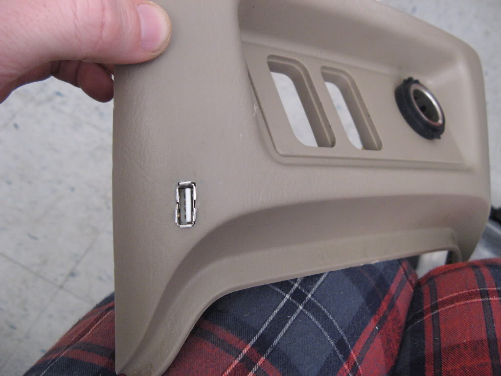

Decide how and where you want to mount your USB plug and pick the appropriate female USB device you want to use. USB has four pins inside and four accompanying wires you'll find when you start to hack apart the cable. Red and black are your ~5v power and ground. The other two (usually green and white) are for data. Though this charger obviously requires no data, it is important to short out the two data cables otherwise most devices will not charge. Short these and install accompanying harnesses for the positive and ground wires you installed on the charger.
Like I said, my original USB mount I wanted to use went to crap so I improvised with this Belkin extension cable. I cut the plastic using a Dremmel and Xacto knife. be careful not to make the hole too big or the plug will pull through. I had to mangle some plastic behind the panel to improvise the fit and drilled a hole in the clip support and used a zip tie to hold the plug secure. Nothing in life worth doing doesn't require at least one zip tie, right?

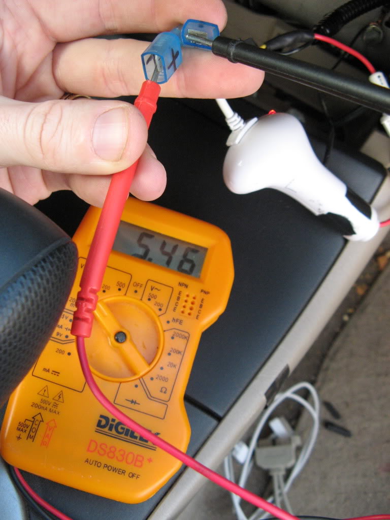

Once everything is safe and secure you can reconnect your car's battery and fire it up to check everything. I got a steady hair under 5.5v. I see lots of warning not to leave devices connected when turning the car on. I tested this with my volt meter and didn't see any spikes. Especially with the inline fuse you should be safe, but you've been warned.

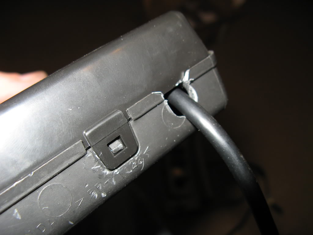

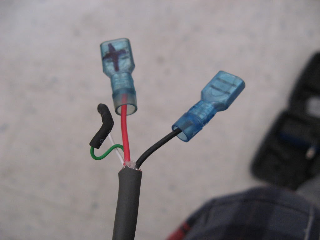

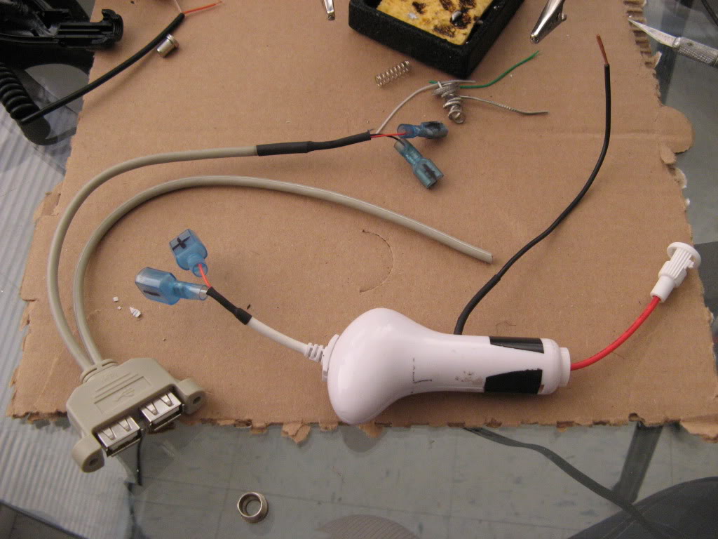

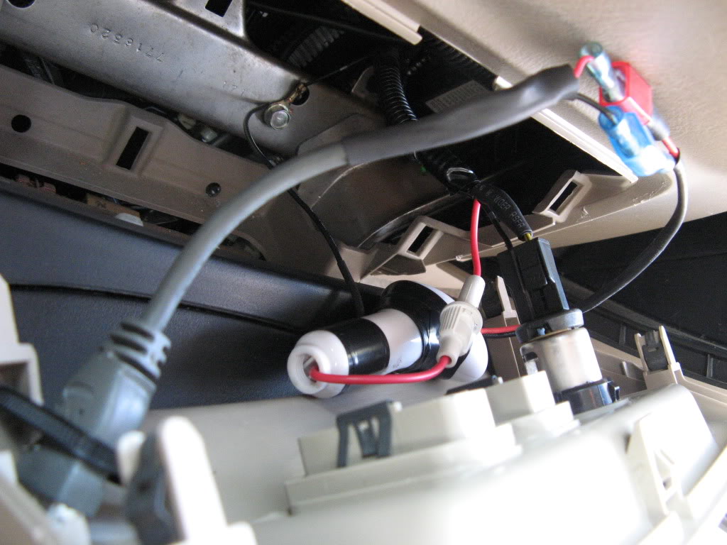

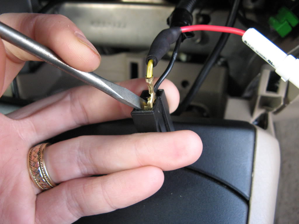

Now back to the car. We're going to need to tap the cigarette lighter's power to make everything work. Take the mangled charger we worked on earlier and head out to the garage. DISCONNECT THE BATTERY AND MAKE SURE YOU HAVE YOUR RADIO CODE. Use a screw driver to unclip the cigarette lighter's positive power (yellow) from the harness.
With the positive lead removed, use a utility knife to remove a bit of insulation from the wire and splice in your fuse holder leading to our charger. Be sure to do a good job heat shrinking and protecting this -- you don't want any shorts!!
You'll see the cigarette lighter's ground wire bolted into to a metal support toward the back of the cavity. Ideally, crimp your ground wire into an appropriate eye hole terminal and bolt it on here. I didn't have any on hand and got lazy and just wrapped mine around the bolt and tightened it. Not ideal.

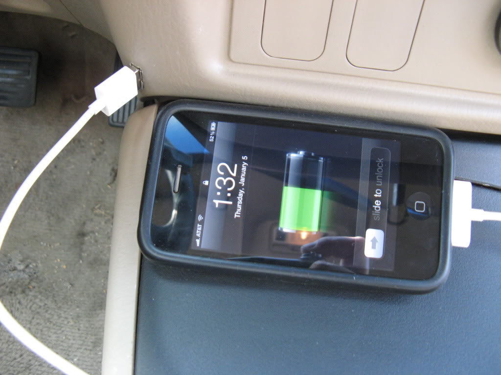

Now you're ready to plug everything in an re-install the panel. Test everything before clipping it back in.
