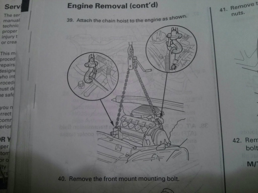

hello I'm going to be pulling out the engine and tranny together. does anyone one a safe and stable place on the engine and tranny where I can strap it on with my cherry picker?

Re: pulling engibe out. where do i strap it from
Originally Posted by lazlong
Wow thanks man. is this in the service manual? I recently ordered one. should be here soon
yes sir, it is
moter, transmission should be removed from under the car drop k member and raise car and roll moter,trans out on a dolly.
