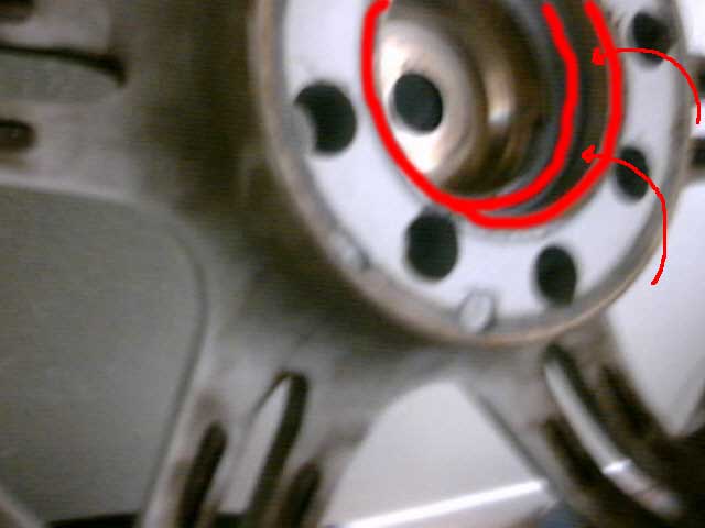

Ok now my question. The first thing I noticed was these tires are LOUD, really loud. Its like a constant whistle, not what I expected, but makes sinse given the really wide tread patches. Are they supposed to be this loud, or will it go away after breaking them in?? Also, after having them balenced they still wobble a bit, & with the lighter steering response it gets pretty wobbly at higher speeds. I think I need centering rings, but I cant find anything on these wheels. The only info I can find is in Japanese, so how would I go about getting centering rings for them, do they have to be wheel specific, or can a shop just measure it & order some generic ones?

Measure the centerbore. There's quite a few common sizes. Then call Discount Tire Direct (the website, not the local store) and tell them you need a set of hubcentric rings that fit XXX to a 56.1mm hub. They're $7.99 + $0.01 Shipping (don't ask, I don't know).

I'm guessing this is the centerbore...

Bingo

Cool. Ill be taking them off tomorow, ill let you know how it goes..
