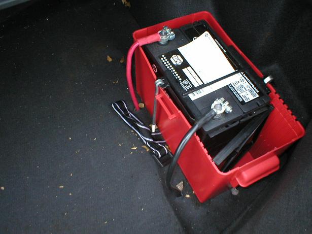

battery is alittle bigger than the stock one, the stock size was to small for the battery box.

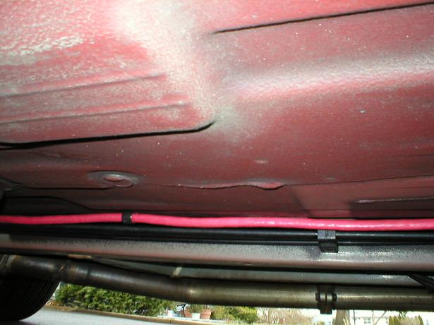

the cable is help up by the round clip things in this picture, we got them from napa. The gromets and everything are included in the kit.

the cable is about 6 inches away from the fuel line, don't try to zip tie the cable to those..not a good idea

Thanks for the pics Hawk. This gives me a better idea of what to do if I go out side VS inside the car with the cable. Looks like you followed the fuel line most of the way. I am ordering the battery kit from Summitt Racing next paycheck.

Alright... I got this done. I made my own tiedown for the stock battery. I couldn't get the Summit **** to fit (battery too small, couldn't get box to close with J hooks and the black things attached to the H bar, so I said screw it. The J hooks hold the box down, the tie down is bolted through the box floor. I may drill 2-4 more holes through the box floor and bolt it straight to the floor pan and do away with the J hooks completely. We'll see, and we'll see what the Tech Inspector will allow. I'm going to overdo it just to be sure my car passes tech, so plan on some more 5/16" bolts going through the floor.
