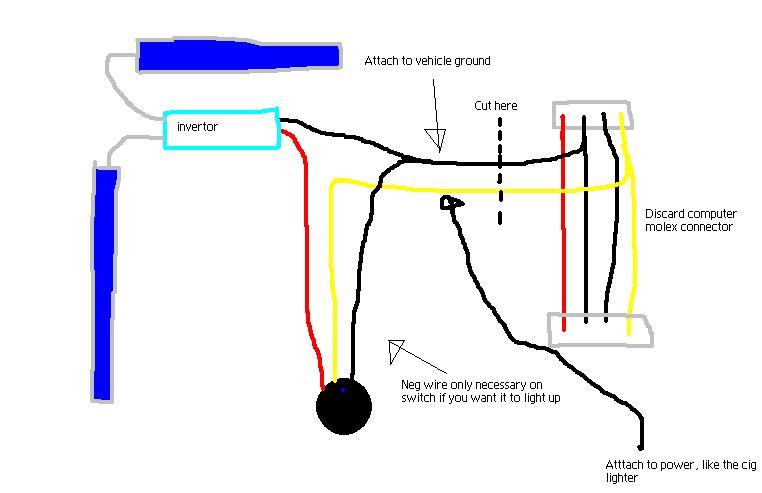

the second one would be a better choice, i cut off the computer wiring and switch, ill paint up a wiring schematic if anyone needs it

Might be a nice companion to the DIY, for those of us who do better with visual then with writing, , such as me.
yes make a DIY with pics please then ull get mad props.....REP!

heres the wiring diagram:

MS Paint, got to love it. lol
lol it looks like a vagina and 2 ovaries
