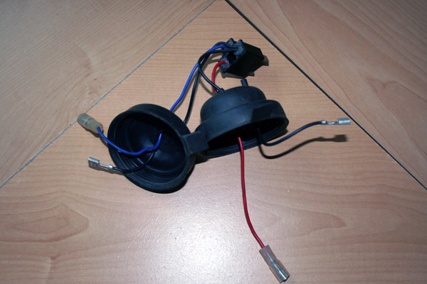

I have a question....if the projectors require H1 bulbs....what do u do with the H4 connectors in our cars, just cut them off and connect them to the H1's? I've never seen the back of projectors, so I dont really know how they connect to each other.
TYC headlights, brand new, will come with an adapter. i'll post a pic in a few minutes

Interesting that makes sense now. Thanx infinite!
