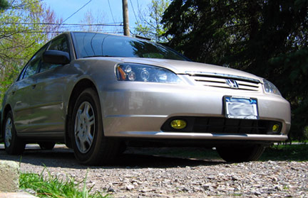

Well after making a new harness due to the crappy/incorrect one shipped with my oem style fogs, I finally got them put in and all wired up today!

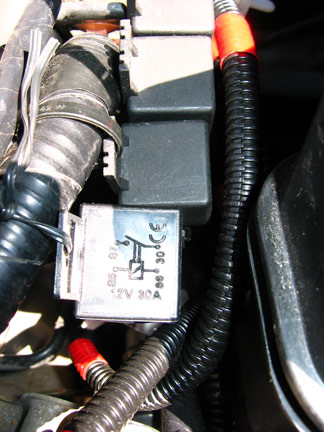

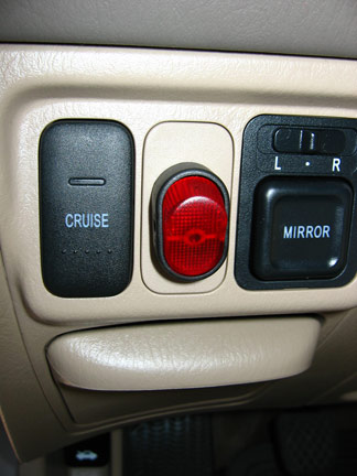

Wasn't too bad once I got the wires where I wanted them.. And did anyone else notice that you don't have to use the grommet under the glove compartment if you follow the Honda Factory directions? There's a set of grommet type dealys on the inside quarter panel area that leads right inside with no cutting or anything, pretty sweet. So I made the new harness with 12ga. wire hooked up to a 4 pin relay and used the parking lights as the relay switch.. pretty basic stuff I guess. Then ran a new switch inside next to the cruise control (a non-OEM rocker swithc, but it does it's purpose).. I must say I'm pretty happy though. Just thought I'd share.
