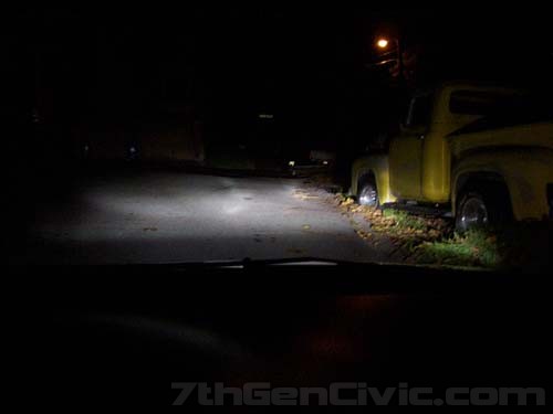

i dunno, maybe its cuz my digicam is super ghetto *** cheap or cuz i have the HIDs aimed to low but how come they dont look as bright as everyone elses that i see? i got the xtec 5000k kit. i have them aimed a little lower than that suggested in the DIY cuz i was worried about blinding other drivers, should i raise it up? anything look wrong?
see how theres hardly any light above the dash then theres that bright patch of light, should it be like that? vvv
even though some pictures dont look that bright it really is bright in person and its waaaayyyy better than stock. what you guys think? any tips, comments, suggestions, help, feedback is welcome.

yeah they are bright, i guess my camera sucks in low light, in the pictures facing the yellow truck theres a house on the left corner and the house was lite up. gonna fiddle around with the aiming tomorrow and see what that does.

It really shouldn't look like that.
From the pictures it looks like it aimed high.
There should be light "above the dash."
Either that or the filament isn't in the same location as stock which would mean a bad install or a poorly made bulb.
You shouldn't worry about how bright it looks when you look at the car.
All that matters is how brightly it lights the road.

the pictures were taking with a slight up hill slope in front of the car so maybe thats why it looks like its aimed high, but they are aimed lower than normal.
the filament i think is ok, no 1 headlight is brighter than the other and i dont know how i could install it wrong since a H4 bulb only fits in 1 way. i want to say my camera is the reason the pictures arent that bright cuz its brighter than stock for sure but looking at other poeples HIDs pictures in the HID post, it isnt as bright as theirs.

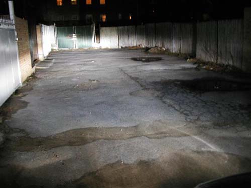

looking at these pictures side by side makes me think somethings wrong. i borrowed this pic from JayFReaZy's thread. we both use OEM housing and 5000k kits. so wtf???
MINE
JayFReaZys

maybe his are aimed up quite a bit higher and some of that is from fog lights?
...just a guess

but damn if that pic was taken w/o fog lights on or if he doesnt have fogs, holy **** im definitly saving for HIDs.

lol better reflector!? his looks like its daytime, mine looks like i'm holding a $2.99 flashing in front of my car, lol. this is crazy, i dont know what the deal is.

Try aiming them UP a little bit more.

well its not the aiming. i went to a garage to raise them up and on my way home i got flashed by a few cars but i still couldnt see the road very well so it has to be the kit somehow. i dunno what i'm gonna do, right now i have them aimed down again so i dont blind people but i can only see a few feet ahead of me.

its not the aiming, the overall brightness is what is the problem.

damn, that is a difference, shouldnt be like that though. I think urs are aimed too low. I have mine at stock height, i didnt touch a thing. As soon as I got the HID's, I just installed and thats it. Yea, I get flashed once in a while, but ****, I wish I could flash some of those other cars that already come "made for HIDs", its no different. If ur in the "beam pattern" ur *** is gettin blinded, reguardless if its coming from a rx-8 projector, or my civic in reflector. I suggest trying ur best to let it go back to stock height and throwing those HID's back in. I can see in the pic, it doesnt look like u can see further than 20ft ahead of u. As u can see in my pics, I can literally light up more than 50yrds. Just aim them higher, and u should be good.

Put the halogens back in, and aim the headlights with the halogen bulbs (so that you dont have to keep turning the HIDs on and off)
I honestly think you aimed your lights too low? but yea... I notice that there is an UPHILL in front of your car? So, maybe thats why it looks low?

Anyway, dont give up man, I just think they're REALLY aimed low. Like impulse said, if they're A LOT better than stock, why change'em back to halogen? From the pics u took of ur headlights, they're extremely bright. Just work on adjusting them back to stock, and im almost positive u'll be happy. If ur worried about blinding other people, then u shouldnt have gotten HID's at all. Plus, who cares if u do? Its not that serious. If they dont wanna get blindind by ur lights, they need to stop focusing on them. People just over react. Yea, its a bit bothersom when I get blinded by HID's, but its not to the point where im like "oooo god, i cant see, im gonna crash!!!!!". All i do is STOP focusing my attention on it, and focus on the road ahead of me instead of on comming traffic and I can see fine.
