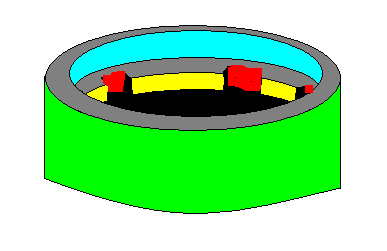

who knows the diameter of the hole for the parking light in tyc projectors for an 02 coupe. Im installing whelen strobes and the strobe light needs a one inch hole. Id rather loose my parking light than drilling a new hole.

at it's smallest, it is .693 inches and at its largest it is .711 inches...you'd have to drill out a bit....give me a min or two i will give a little diagram

picture that "graphic" as the sochet....
the yellow, inner most diameter is .593 inches
the red, second smallest diameter is .711 inches
the light blue, the second largest diameter is .915 inches
the green, largest diameter is 1.069 inches...
just measured with my caliper....i have a set of tyc's just sitting in my room, i didn't actually go out to my car and measure....so you would have to drill out a little into that raised ring between the light blue and the green...
I hope this helps....

your talking about the actual hole in the housing, not where the harness connects to the bulb, right? thanks for getting that information so fast

yes, that's what you see on the back of the housing...the hole on the inside of the headlight is prob just under .9 inches...you can make it fit....if not...i do have a set of strobes that fit perfectly in there....a little on the loose side and you might need to crimp some extra wire on to it, but they will work with less modification....
