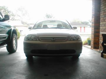

Just got these projectors in...waiting for new bulbs, so yeah, the light's kinda yellowie, but gonna fix that soon. and yes, you do have to take the bumper off to remove/install any kind of headlight fixture. Real easy job tho, just a few screws and pins and 2 firm yanks, and it's off. the bulbs are completely different from stock, H3's as the lows and H1's as the brights. The turning signal and parking light is the same as stock, but you may want to buy some amber and green to match stock, or blue if it's your thing. 168 is the peanut parking bulb and 7443 is the larger turning signal. the fixture has the 'angel eyes' installed already, but caution, installing them by splicing the stock wires will void the warranty, i called up the honda place and asked. i'll sit and install them some time down the road. ohh, and if your in the market for projectors, shop ebay, ALOT. i watched ebay for 3 weeks and bought these for 100 w/ shipping, most others are 130-160 w/o shipping. Tell me what you guys think! i'll update with better pics soon...

Those appear different from TYC or the HALO projectors. I believe these are the "crystal" set.
Is the light output any good?

looks nice! AIM them correctly =]

paint them black!!

yeah, i wanna know what the light output is like...

looks pretty good.

Yeah those just came out.
