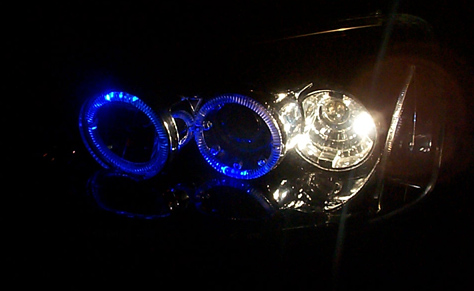

Ok heres what I did. I had the black Sonar projectors and the leses went bad so I ordered a new set. I got the chrome ones instead and had everything painted the color of the car except the chrome rings in the lights. I used the extra set of halos to put them over the high beams and installed better blue T1 LED's into them as well. To top it off I have Audi HID projectors. How badass are these? I dig the way it make the front end look. The hood, tinted front window and painted grille help too. Opinions?

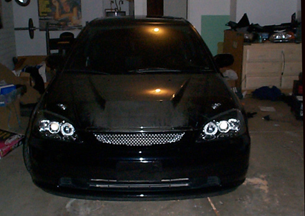

Front end

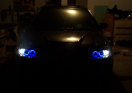

Parking lights

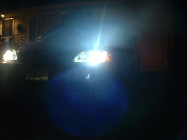

HIDs

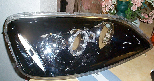

up close

I did a retrofit with Audi S4 HID projectors, d2s bulbs and BMW Ballasts. I like the X5's. I was just at the BMW dealership checking out the new cars and the new Bi-Xenon Projectors use the "self-leveling" process. It looked awesome, but the assembly looked far too large to fit in our cars.

Buy 2 sets of headlights and use the halo's from the spare set. Impulse, I wanted to use the BMW halos since they use fiber optics. They get so much brighter but the halos were way too big.

It's just glue man. Not difficult at all. Drop it off at the paint guy. Put it back together.
