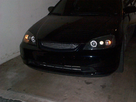

My OEM Retrofit: Projectors are both way to low (meaning not adjusted properly... will be fixed soon, damn snow =\)
Hella Bi-Xenons:
s2000 Projectors: In an s14
Attachment: Valeo Projector Beam pattern (Same as mine If i ever get a chance to adjust my projectors :x)
I will update pics soon

I'm getting another set of the same lights so i can mold the insides to look more unique and I'm painting it NBP. I'll post when I get em done. (Don't doubt me Impulse lol) Maybe I'll point that passenger projector up a little too.
