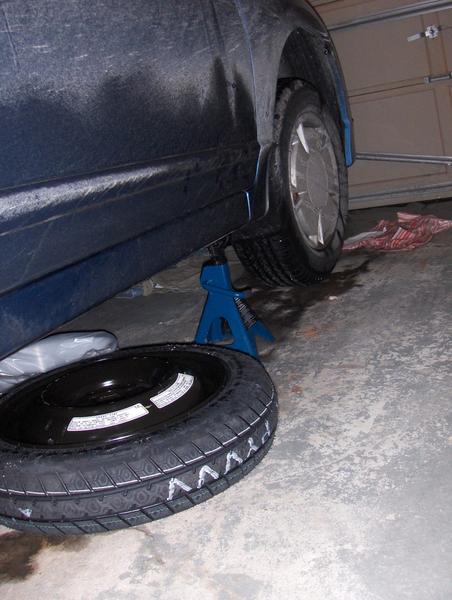

I also have some pics of how I have the stands used as I could not find ANY arrows pointing anywhere for where to put the jack stands or the jack....

No Arrows found for stand:

Also, are my jack stand put in proper place?

Good job man... but next time use the tire you took off not the doughnut. haha this picture is a riot. The doughnut wouldn't save you from getting crushed, the bottom of the car wouldn't even touch it.

You are right :-) it is too thin. I just didn't want to take out a tire.
To be honest, first time going under the car was scary but each time I shook the car a bit heavily to make sure it is stable.
I am still not very clear on where the jack and stands should go. If you zoom my pictures you will see that there is a ridge and that is where I put the stands while I used behind the ridge (more toward inside of the car) as the point for jacking the car up. As I know I will need to do this more, I would like to know which parts of the car are strong to support the jack and it's stands.
P.S. I drove the car today and when it was ON I gauge the fluid and it was fluctuating drastically over upper mark and then on the lower mark....so it wasn't consistent reading. I turned off and my measurements were all between the upper and lower mark.

There are three areas that you can safely put your jack stand.
The ridge you used; the four jacking points, which you can find in your owners manual; and the tow hooks in the front and rear of the car.
