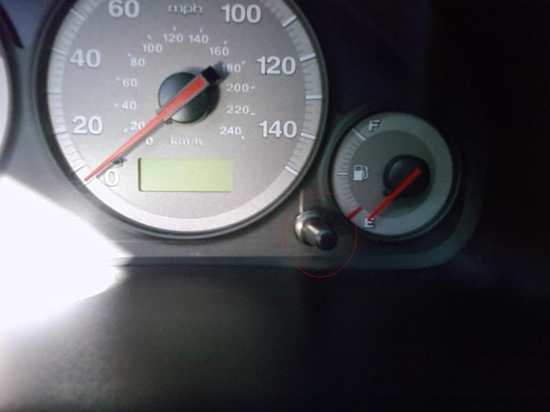

Yeah, that black trim I can't even take out. I unscrewed the two top screws, that's no problem.
But the buttons, which I circled in the picture, is in the way of pulling it towards me.
And I can't seem to nudge the bottom part of it either.
Old Feb 21, 2008
Re: replacing guage lights in speedometer cluster
those buttons have no connection to the black bezel. they are part of the cluster. what you need to do is try and stick your fingers inbetween the bezel and the cluster plastic at the back, i know theres no room but try. then you really have to pull hard straight back with all your strength. it is glued in on the bottom too so the first time will be very hard. after that the glue wont really stick anymore so its easier to snap it back in. if you still cant figure it out, ill go take a pic where your fingers should be.
