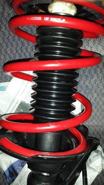

Im installing a set of Tokico DSpecs matched with a set of Tokico 5907F-P lowering springs.
My questions is, how do you know which way to install the spring? The most obvious thing i can think of it is the words printed on the spring facing up not downward. Is the correct?
Also, I didn't have to use a spring compressor to get the bolt at the top of the shock tightened all the way down. But I can push down on the spring enough to create pace between the strut plate and the strut mount?
Is this supposed to be right because the lowering spring is smaller in size than the factor spring? Or should it be really tight that I cant budge it?
Thanks for the replies.

Where did you get those springs from? There is how to index your strut post in here somewhere search for it it should show you how to. If these are lowering springs you dont need a spring compressor when installing them you might need it when removing the stock springs.

Some springs it does't matter but it should tell you in the instal instructions.
Thats normal. Your new springs are shorter so they don't require as much compression to get them low enough to put the nut on.
The spring is narrower? This depends on the spring but yes they can be narrower.
It will tighten up when the car is lowered. They can not be as tight when the suspension is completely in the air.
Make sure they are indexed properly though. Look for the thread that was mentioned above.
